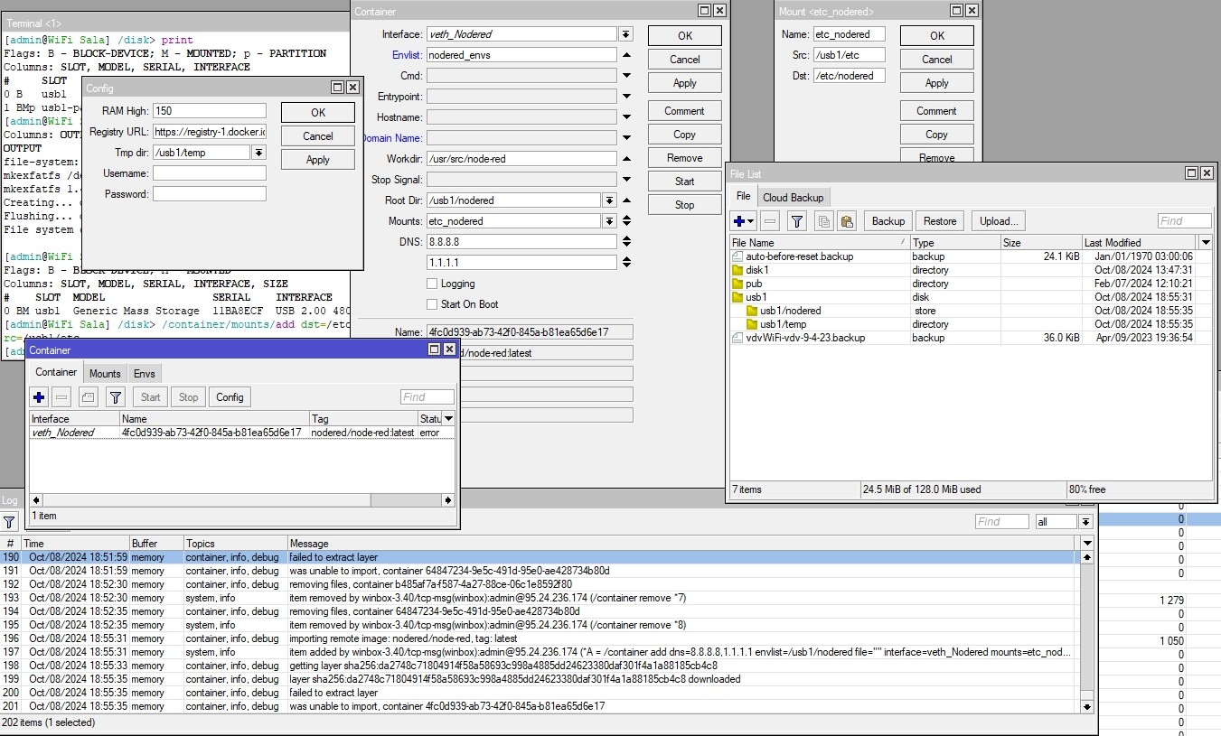

So I’m trying to mount it on an ac3 arm router and I got error, it downloads the package but whne start extact I got error. I can’t figure out where is the problem, the USB stick has been gormatted by Mikrotik itself..
Thanks for help
I’ve solved it partially, formatting with terminal the USB on ext4 I was able to continue the extracting, I’ve monitored USB disk and it wrotes about 700MB, then the process went to stopped, and start it doesn’t effect. If I reboot the router I can’t see more the container. I’ve wiped and formatted again but no success, logging reports only getting and dowmloaded. I’m using an old 2GB usb stick but it was never used, it should be fine. I don’t have write errors or any discard. Only 10MB more ram used, I don’t now where the problem is.
The working dir /usr/src/node-red does not appear. In my opinion something goes wrong here.. I have no ide why it interrupts
The process and commands are the same as CHR, you just have to watch before on Files and see how Mikrotik named the USB drive after format, in my case usb1/. SO the commands will be:
/container/envs/add name=nodered_envs key=TZ value=“Europe/Moscow”
/container/mounts/add dst=/data name=data_nodered src=/usb1/data_nodered
the temp disk wil be usb1/temp
the root disk usb1/nodered
depending on the flash drive speed, but it could take long time to extract all
Before installing container I haf 174MB RAM free, after extaction 159, rebooting no cotainer and again 174
Beyond formatting the USB on RouterOS, which sounds like you’ve. And do not reuse the same root-dir name, without make sure is deleted from files …
This does looks like another gotcha with starting “paths with slash”. In RouterOS scripts/config, file paths do NOT generally start with with / — so use
root-dir="usb1/nodered-root"
and in /container/config using tmp-dir=usb1/push.
It is very confusing whether a path should start with a slash. In /container, root-dir= and tmp-dir= (and CLI only, layer-dir=) all should use paths that start with “usb1/mycontainer/root”, “disk1/containers/”, etc. — NOT “/usb1” or “/disk1”.
Now to make this especially confusing, /container/mount, may want the preceding slash (or at least it does not care). And external file access like scp/NFS/etc, RouterOS paths DO start with a / to keep the external tools.
Maybe not your issue … but these file paths will get you with /container sometimes…
Thanks friend for replying, yes I’ve noted that too and I agree with you, I’ve made several attempts, sometimes mikrotik add itself / after removing it.
Anyway, such commands worked on CHR and it seems they have to also on arm+external drive, but they don’t.
What suspects me is that it is not comparing the working path, something goes wrong when executing the script after installing files. I see the about 700MB been written on USB1, so the process fails on the last stage. Maybe there is an incompatibility between this NR image and mikrotik container 7.16 version, or maybe simply NR pretends to install and find itself on the native disk..
Have you the chance to try too? Do you have an arm router?
Maybe I have to open another topic asking help for this. Unfortunately we don’t have good instruments to debug the process and find the reason
Ah… I tried it when this thread started on RB1100AHx4, with is also 32-bit ARM… And I check again, still works using :latest. BUT… RB1100AHx4 processor can use linux/arm/v7 as the architecture.
I believe, and don’t have one to check, but the hAPac3 needs linux/arm/v6 (as I that’s what’s needed on hAPac2)… And looking at DockerHub, all the newer 4.x dropped support for linux/arm/v6 - which must be what’s going on here. nodered, outside /container weirdness (like paths) in RouterOS, has always just popped up without much trouble. Now, no security does make that easy.
Anyway, so the new theory… try the 3.x branch of nodered, which does support linux/arm/v6
Back to the post title “Running Node Red on container, which one?”, let’s go with:
remote-image=“nodered/node-red:3.1.12-minimal”
(you can drop the minimal, or do your own research on the specific packages… but I’d try the minimal just to, hopefully, see something working.)

Hi mate! Thanks again for your support!
First I did what you suggested,I’ve used nodered/node-red:3.1.12-minimal (works without “”), bufore I’ve format the stick, checked on Files that all gone there and usb1 was remount displaying only “lost folders”, checked again all unnecessary “/” and applied. This time it download about 300MB, but the process hangs, no more byte were written (as happened before), keeps extracting but don’t do anything, no logs error.
I suppose also this version is not compatible with this router, possibile?
About your script, thank you, please sorry me I haven’t tried it yet, I don’t think it does more/different that what I’ve already tried, paths are the same, it doubles veth and mount I’ve already configured..
I?m going to write to githup asking for support
Feel free to ignore the script – it shared since I had it and what I used to test.
But kinda I’m out suggestions. You have:
  • ext4 format on USB
  • using slash-less paths for root-dir / tmpdir
  • an image that match the architecture – on hAPac2/3 this may not be easy but we confirmed DockerHub has linux/arm/v6 images
    Since NodeRED generally works under RouterOS – must be something about the hAPac3 and/or USB disk. The what is a mystery still a mystery here.
Does loading a plain container like “alpine” work?

  • NodeRED should start from shell based on the last command… Try the port in web browser (… if look like it started …)
  • If it works…exit nodered and shell with a few ^C, the go back to container UI and…
  • Stop container to change “cmd=”
  • Set “Cmd:” to just node-red
  • Start Container
  • it should should work same as when you started it using shell, if it does…enable the boot-at-start=yes option.
But we’re really grasping at straws here.
Dear friend! Yes it works :slight_smile: thank you a lot! here my considerations:
Intalling Alpine is very quick, it looks very light
Installing nodejs as well as npm takes few seconds only
Installing NR needs quite a lot, about 5 minutes, that’s a sign it works slow, for sure not the proper platform for it. The beginning 174MB free RAM (after booting router) can go to low to 58 during the installation, as well about 60 while installing palette, processor can go about 35%, looks that only one core of the processor is running here.
NR 4 a
I need to test it to tell more, for now I’ve installed telegrambot and dashboard, you need to wait a while to see them installed, chances are also my USB stick is not good performing with thousands of small files.
Yes changing cmd is booting auto, now I’ll try to make a very short guide for who is interested.
Unfortunately node-red-log is not working, so the only way to see logs are log on winbox, or maybe typing manually the bash, which I don’t remember )
