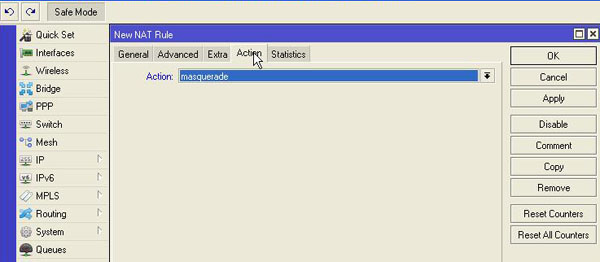

You can nat the interface with one from the PPPoE as WAN
Try like this, is an example but must work.
