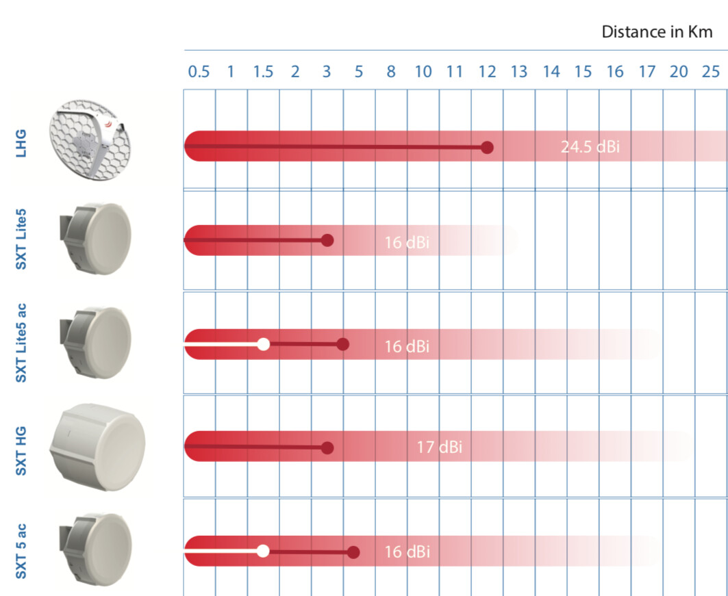

In addition to an SXT, I’d consider a LHG5.
Price on both is about the same, main difference is LHG5 is way bigger, has almost triple antena gain vs SXT sq 5, 100Mbit ether port vs 1G port, and LHG is N whereas SXT sq 5 is N/AC.
But… I think 100Mbps sustained is perfectly enough for an IP cam.

Also looks like the LHG5 is only good for 1.5km so not idea for what im doing to be honest.
Have you seen it? It has been designed to stand strong winds, frosts, snows… I also think it is a sturdier design for your conditions regarding moisture, etc…
Reference: Mikrotik PtP Guide a pair of this will provide a solid reliable link for larger distances than you need…
All I can say is you’d better factor in climate (fog, water masses hops) and other potential losses, this antenna does it by pure physical design (gain) and that requires a size, but doesn’t seem to be an obstacle in your scenario; in urban, crowded areas, a SXT sometimes is a requirement because of being much less conspicuous than bigger ones, mostly to comply with local urban regulations.

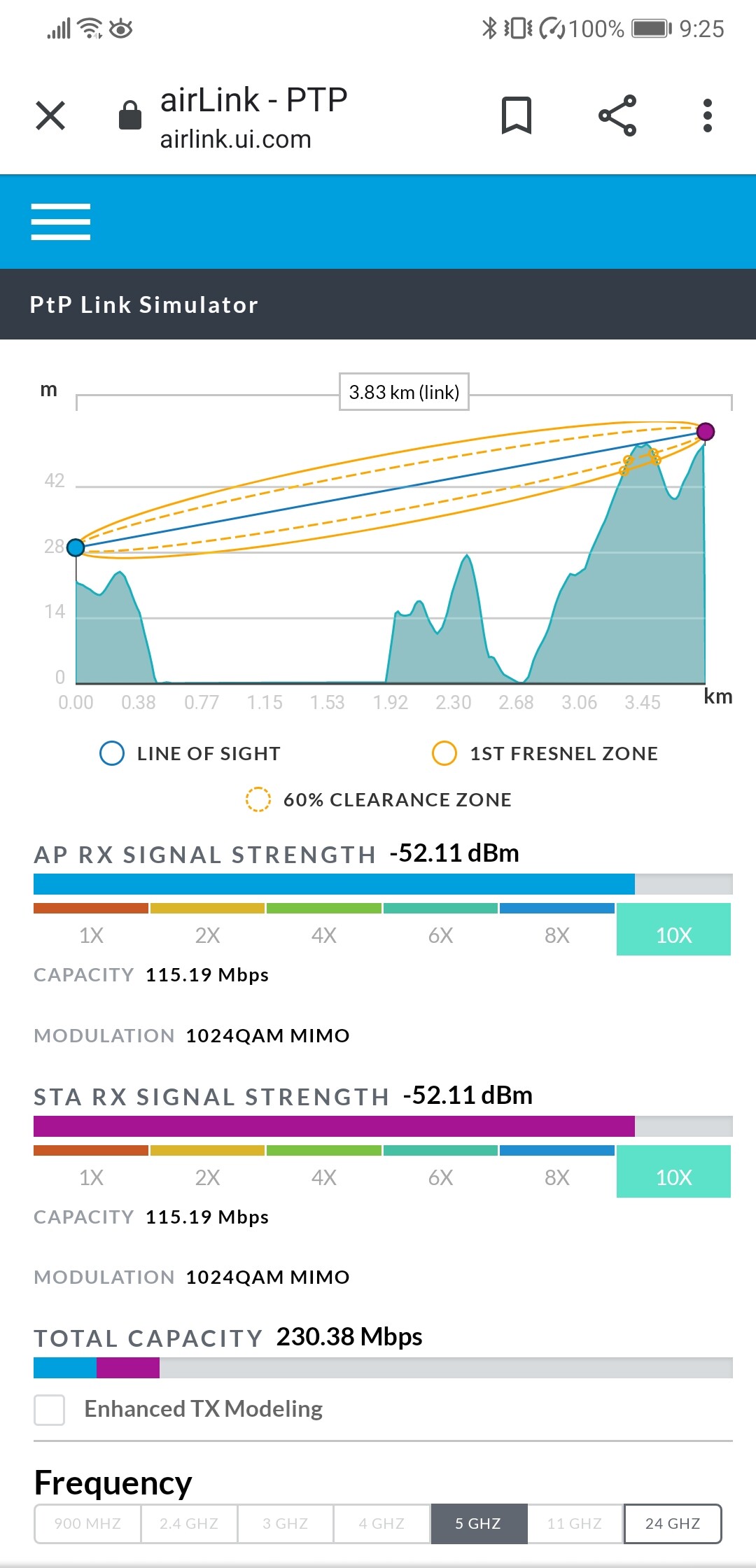

In addition of Direct Line of Sight, you need to check if there’s an obstacle in the first fresnel zone of the link.
What are the GPS coordinates of each point? I referred to a screenshot of a Link Planner calculator or Google Earth to see a cross section of the PtP terrain elevation.

Here is a screenshot of the ubiquiti planner, it says theres a hill in the way but from being there as you can see in my earlier photos there quite clearly isnt. Theres a dip in the hill you can see through.
That hill is obstructing the fresnel zone, I’d mount both as high as possible, play with antenna heights to see what would be the minimum…
The thing is from what i could see i dont think it is, the reason i say that is the fresnel zone has a 25ft radius for 5ghz, and the end of my house is 27 feet, i can see the full gable end over the top of that hill from a 5ft camera tripod. Doesnt that mean if got at least 25ft clearance? Or have i worked that out wrong?

I think it will work although i do not like that obstacle there… You should certainly use a higher pole for that Antenna and avoid that obstacle as much as you can (Better Performance)…
