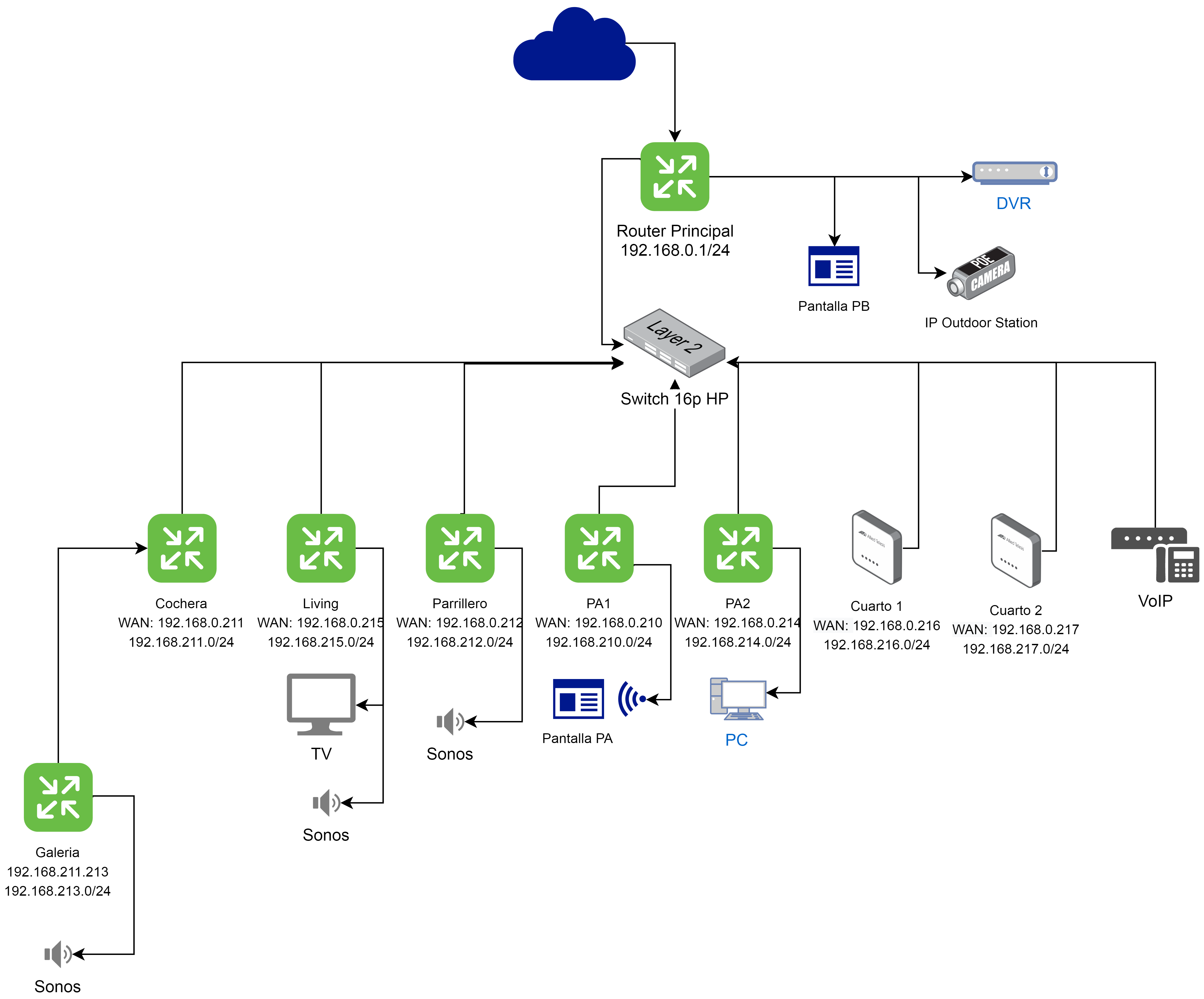

Hello Goodnight!! I am new to the mikrotik forum and something new in the topic of routed networks.
I want to raise my problem and that I have been observing that there are many with the same subject.
I could not find the file, I have tried the solutions but something I do not understand or it does not work on the PIM or IGMP-PROXY.
I show you in the attached file the structure of the network that I have.
What I need in any segment of the network, SONOS speakers work, I was seeing that multicast and broadcast traffic should be routed?
I tried ICMP-Proxy for hours, but I see that I don’t understand how IGMP-Proxy and Upstream works, does anyone know how to configure IGMP-PROXY? Does the IGMP-PROXY allow the bidirectional traffic of the Multicast?
I do not know if I understand … I repeat I am half new in routed networks, but first time I find myself in front of the teams that need multicast.
Most answers for that kind of setup is NO, because most network-connected speakers and media players (Sonos, Apple TV, HomePod, etc.) require the devices to be in the same broadcast domain (same subnet), and won’t work in a routed environment except for one case: using a mDNS/Bonjour proxy.

Thank you very much for your comments.
I’m sorry something I don’t comment, is that I have RIP routing routers working.
What I did with IGMP-PROXY was to achieve multicast traffic to the main network, 192.168.0.0/24, this means that the client that is connected directly to the main router (that is, has an IP of subnet 0), can see Speakers and use them, but don’t manage to do it with the other networks.
