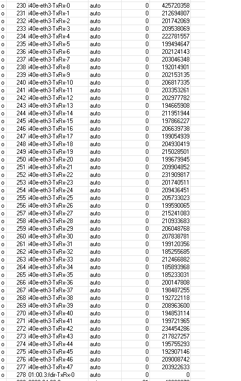

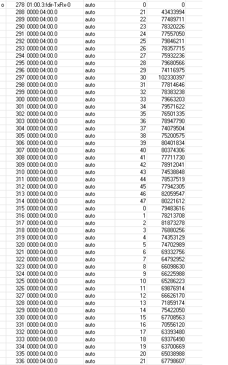

one other thing that confused me was on the IRQ site… it shows eth0,eth1,eth2,eth3 when i disabled ether1 and ether3 on the interfaces intel x710-da4 card.. i40e eth0 and i40e eth2 disappear letting just i40e eth1 and i40e eth3 counting the mellanox card where our main link is arriving its not displaying on the irq but this one we have no errors on it.
i then understood that i40e eth0 = ether1 i40e eth1=ether2 i40e eth2= ether3 and i40e eth3=ether4 on the interfaces the irq aparently starts splitting traffic from ether1 on i40e-eth0 as shown on the pic bellow seems like its splitting traffic across the cpu cores..the mellanox also are getting traffic split across the cpus even do it states that the only active cpu is 0 on the cpu count..
on the mellanox card irq it displays various counts cpus active..

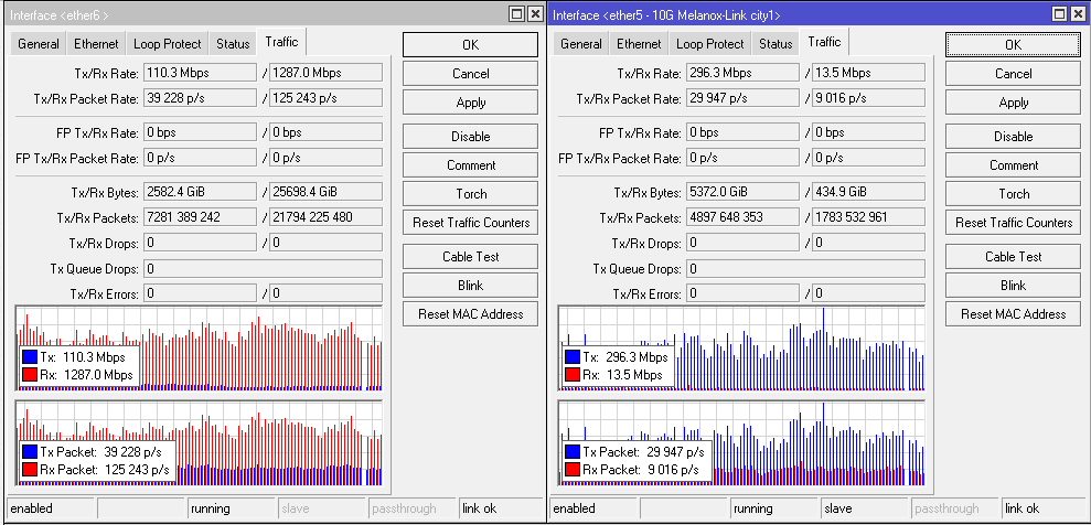

but we do have other ports of the intel card also running connected directly to the OLT fiber devices.. and no errors on those ports..
we have vlans on the ports also.. and no errors on the vlan interfaces

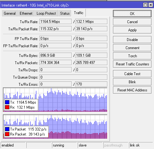

even the intel interface connected directly to the BGP also has a vlan setup , and no tx/rx-erros on the vlan.. only on the physical interface we see the errors. around 4k packets every 24hours this gives an average 2,77 packet loss per minute (but we go get odd couple of packets increase after couple of hours.. sometimes it stays around 4 hours with no packte count, then all the sudden around 100 packets increase… on average traffic of 3.5gbps download and 250mbps upload passing through the interface directly… its the internet wan gateway interface that connects the PPPOE router to the BGP.. disabled auto-negotiation also, let if fixed on 10G SR LR but also get errors.. the MTU on the interface is 1580 also..aldo the L2 mtu allayws stays 0 we cannot change it on..

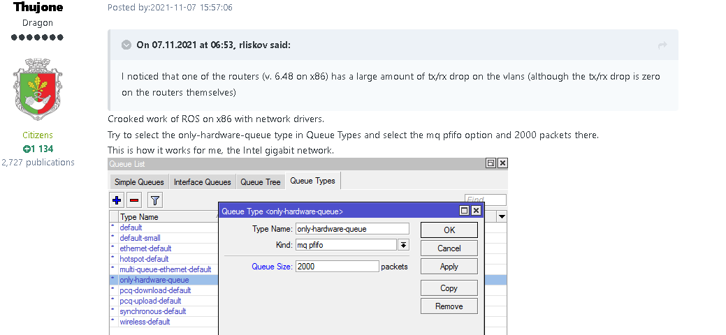

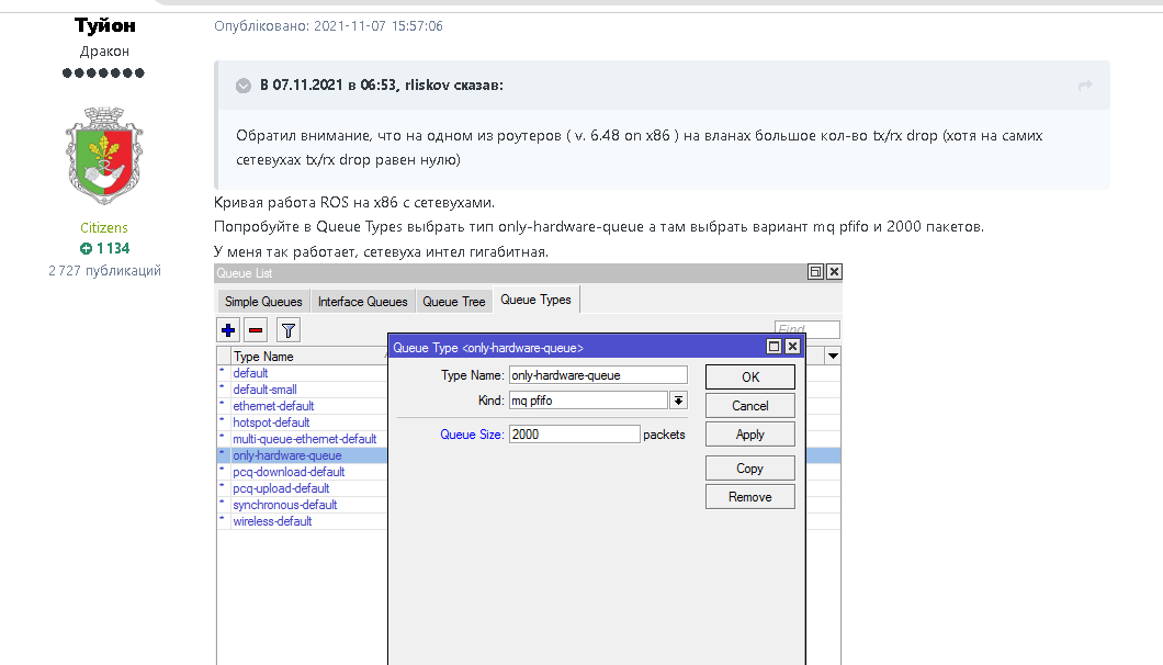

as an update whilst googling i found ukrainian site where people were stating the same issue with intel nics on x86 version rOS 6.4xx
and i will give it a tryout later on, even do its an issue related only on the VLAN port on his side..
ok did the test.. running torch it still counts on rx-errors but slower… on packet-sniffer it counts the RX-ERRORS alot faster..
now the strange part… i have on the CPE client side.. under pppoe connection a few windows open with ping -t xxxx.xxx.x tó diferent places…
and not even a single packet loss. after hours running.. so aldo it counts around 20k RX-ERRORS per day we don´t see any PING loss on the pppoe-servers.. strange
