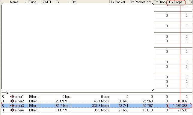

I’ve been there a while noting that some of my routers interfaces is presenting rx drop, but this is never presented any abnormality in the network, but yesterday I got a router to have several rx drops, so I was unable to solve the problem when I took the negotiation auto interface , it still happens the rx drops, anyone had any similar problem?
I’m guessing packets are being received faster than the device/router can process them. 337 Mbps / 50,000+ pps is nothing to sneeze at, especially if you have firewall rules. Also do you have any queing going on?

If the RX dropped is a very small percentage of the total packets received (i.e. you have 1 million dropped packets out of 1 trillion received), you probably don’t need to worry about it, though 0 would be nice :sunglasses:
Otherwise, you can try to simplify or optimize firewall rules, or look at faster or multi-core processors/busses. (along with newer routeros versions that utilize multiple cores better, if you aren’t already). You could also consider moving the firewall rules elsewhere (assuming this is the issue).
If you have gigabit in, and 100Bt outs, it may just be getting backed up occasionally (you could modify queues on the outbound interfaces to hold more if this is the case). (Although, as I think about it, that would probably show up as a tx drop on the outbound interface instead of a rx drop on the inbound interface).

If there is an instantaneous demand for more than 100% (or 400% depending on how you look at it) cpu it could be a momentary problem that wouldn’t necessarily show up as high cpu usage in general (perhaps the interface was operating at 400,000 packets a second, for 100th of a second).

What percentage of the total is the rx drops working out to be?
