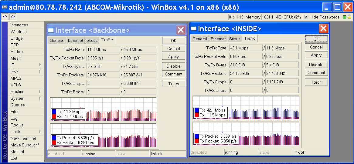

the server has tw0 ethernet gigabit interfaces and Dual Xeon processor .At the 45 Mbps ,both interfaces have Rx drops (no errors)
Attached is the print screen of the interfaces .

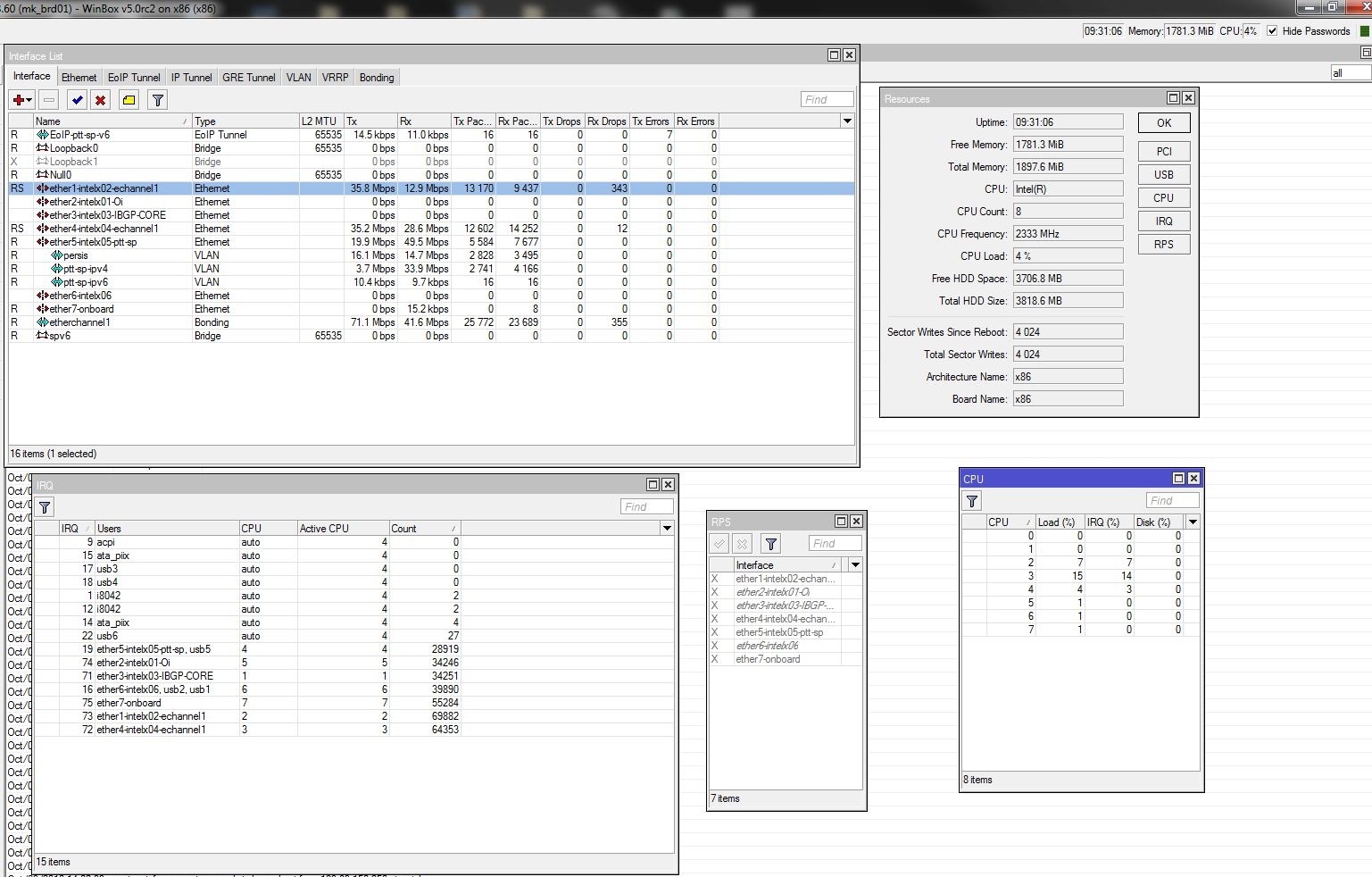

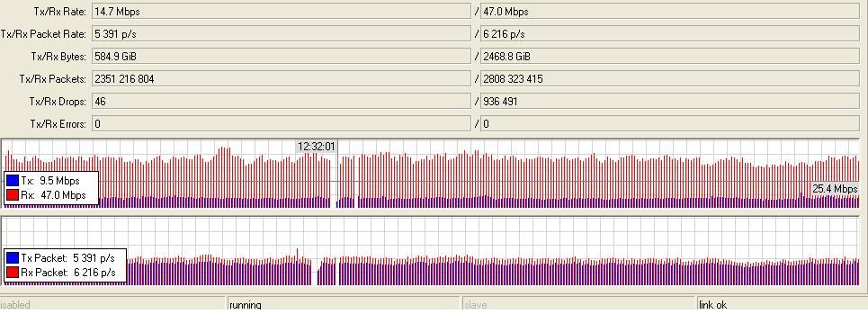

i kept the multi-cpu=yes and set no auto-negociation. The Rx drops stoped, but stil have some problem like the image attached.
this is what happened when had rx-drops.
