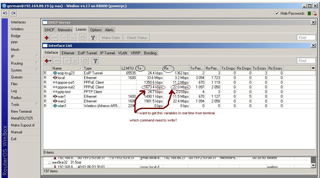

Hi, in picture i write what i need.
please help
/interface monitor-traffic pppoe-out2
thanks,
i need to check every 1 minute with script “rx-bits-per-second” value of interface and if it 0 mbit need to reconnect interface.
how can i do it?
/interface monitor-traffic LAN once do={:put $"rx-bits-per-second" }
How can apply this to TX RC bytes (not bits)
THanks.
/interface monitor-traffic LAN once do={:put ($"rx-bits-per-second"/8) }
