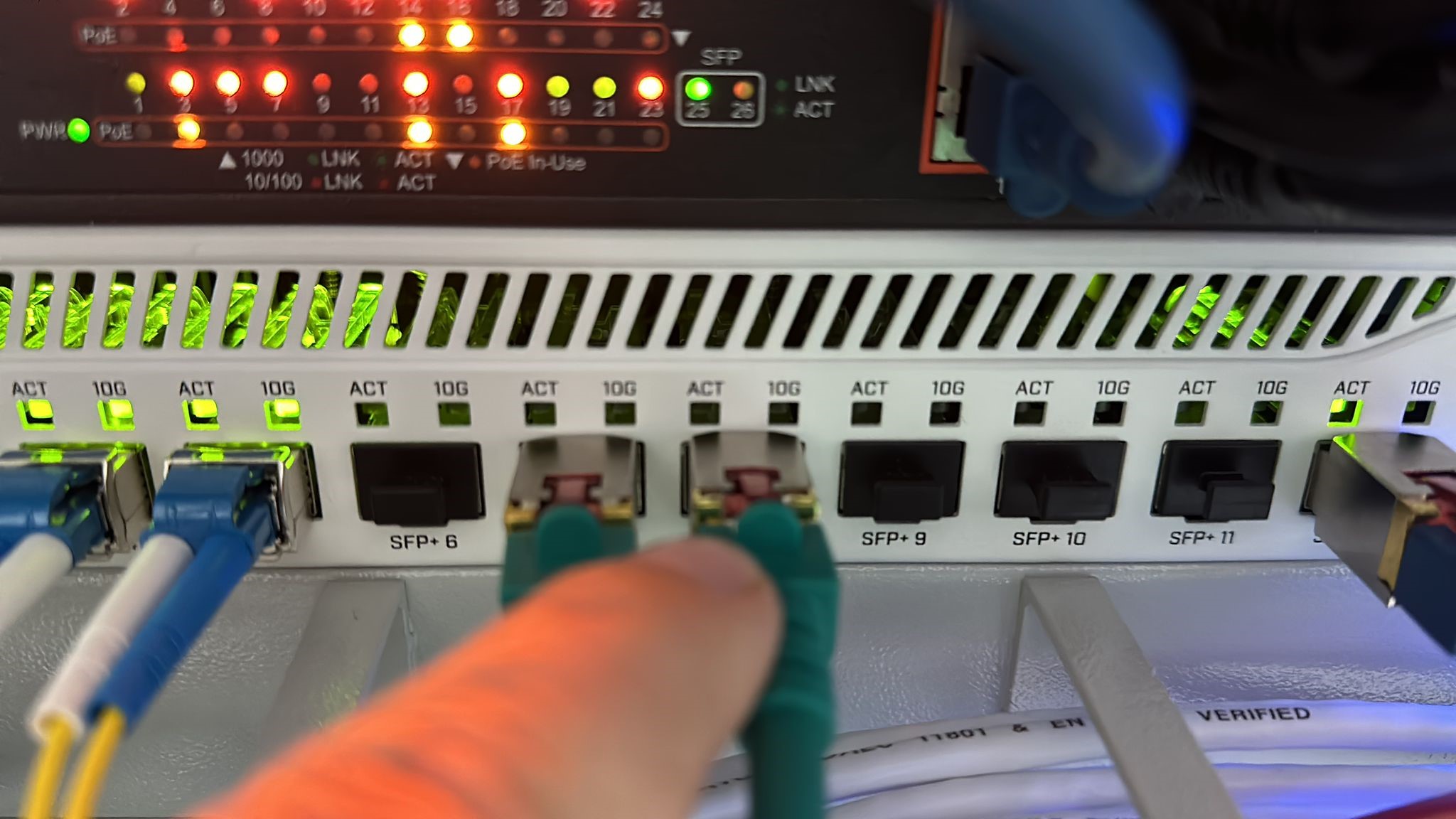

I have just had an entire LAN drop after both DNS / DC servers dissapeared from the LAN.
I took me about an hour (it is a very large site) to find out that after the restart of the main router (CCR2004) where I use them to connect servers to it using copper the simply did not start.
I have temporarily connected servers to a VLANned switch, but I wonder is the S-RJ01 reliable at all?
Or are there some caveats I am not aware of?
