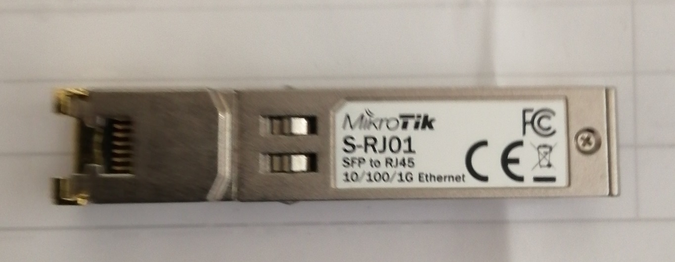

I have an S-RJ01 plugged into a router and it will not work when connected to a TP-LINK router LAN PORT, it will work if connected to a MikroTik router LAN port, nothing else has a problem getting an IP address and allowing connection to Internet

It is an S-RJ01, see picture

I have plugged it in to a Ubiquiti UDM-Pro so I can use the built in failover backup but it will only communicate with MikroTik devices, ( Routers Switches ), it will not communicate with anything else i.e. TP-Link routers, not even a Cisco router, is it faulty or is this by design?
Not actually made by MT but for MT by a generic maker so it should work. Strange…
I have discovered the problem, it will only communicate with gigabit ports on other devices when used in a Ubiquiti UDM-Pro and the ports on the other routers I was connecting too only had 100Mbps ports, that is why it was not working, now it is connected to a BT smart hub it is working, need to put smart hub in to half bridge mode now.
