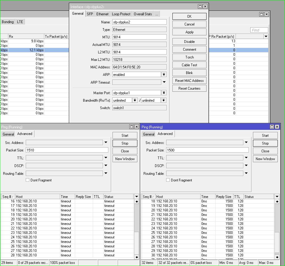

Maybe anybody knows how to enable (if possible) Jumbo Frames on CRS317-1G-16S+RM with S+RJ10 modules? I changed MTU and M2LTU on 9014 but packets bigger then 1500 are dropped. With standard SFP+ fiber modules jumbo frames works fine. Tested ROS 6.40.6 (bugfix) and 6.41.3 (current) - no differences. MTU displayed 9014, max MTU supported 1500 !!. Did S+RJ10 not serve jumbo frames?

Switch1 is connected with Switch2 via SFP1 on both devices. Two workstations are connected via SFP2, both with the ASUS XG-C100C 10 GbE NIC. If the MTU for every device and NIC is set to 9000, there will be no connection between both workstations - but: each workstation is able to ping the switch they are connected to.

As for “each workstation is able to ping the switch” - with what maximum ping size?

According to Mikrotik support the S+RJ10 modules ‘currently’ do NOT Support Jumbo Frames.
However, i did not get any answer if this as firmware/software limitation and might change in the future or if this a permanent hardware limitation.
