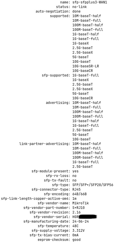

I have bought the S+RJ10 and pluggin in a ccr2004-16g-2s+pc router.
The card is recognized, but when I connect the ethernet cable of the ISP’s router, it shows no link, no leds light up.
Also, I’ve tried to set the speed to 1Gbps or even 100Mbps, with no change.
The ISPs router is in bridge mode and uses pppoe for connection.

CCR2004-1G-12S+2XS – supports up to 6 simultaneous S+RJ10 modules. i asume you cannot use free sfp cages for thermal reasons
Ok, I know they overheat, but it did not work out of the box. There is only one such device plugged in the first SFP+ port of the CCR2004, I’ve tried with auto link negociation, with the expectation that it will negociate the 1000mps link speed, but it did not, as it shows No Link.
This is when I tried to set fixed speed, as it was suggested on serveral forums. But it still did not work.
Temperature is around 65-70C, so it’s definitely not an overheat issue.
Once they install the 10Gbps line the ONT will be changed to a new one that has an ethernet port of 10gbps. I will try it with that one. But still, I was expecting that it will work also at 1 Gbps speed.

Have you been able to resolve this? I have the exact same issue with my recently purchased CCR2116-12g-4s+ using a S+RJ10 module.
