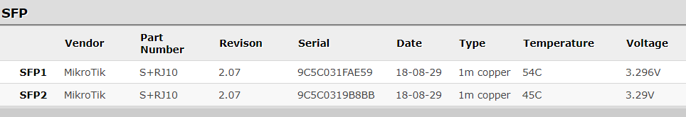

2 x 2.07 revision modules in a CSS326 used as pass-through for testing @ 1 Gbps until the 10 Gbps nics arrive.
Without active cooling, the darn things get to 70 Celsius fast. Can barely touch them.
With active cooling, a small 40x20mm Noctua fan right on top of the modules blowing down and another 40x20mm Noctua on the case, pushing air inside from the back, one module gets to 55 Celsius maximum while the other at about 46 Celsius maximum. I guess the temperatures will rise when @ 10 Gbps.
To stop air just escaping through the back holes, I blocked all of them. Blocking the back holes lowered the modules temperature by 5-6 degrees Celsius.
At first I thought I mounted the fan incorrectly, but if I switch the modules in SFP ports, the hotter one will still be hotter and the cooler one will still be cooler. I would say about 9 degrees Celsius difference between modules with the exact same traffic on both.
