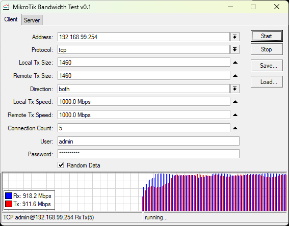

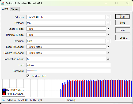

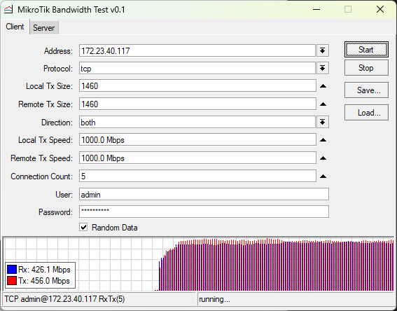

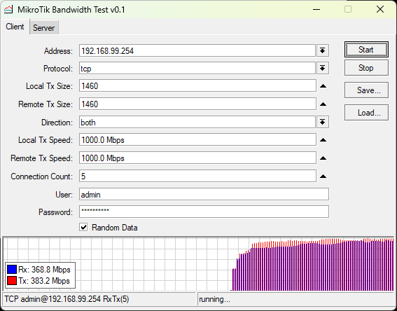

After much pondering on this matter for too long, I decided to test for myself with the hardware I have, to provide some wider context. I used the following setup:
  • hEX S (2025) (EN7523 – dual core 950 MHz) Router OS 7.20.2
  • hAP ax lite LTE6 (IPQ-5010 – dual core 800 MHz) Router OS 7.20.4
  • 2x Windows PCs with MikroTik Bandwidth Test v0.1
PCs were connected to ether2 and ether3 ports. Both ports on the same bridge but each in a different VLAN, bridge VLAN filtering on.
I played around with different packet sizes, TCP vs UDP, different directions etc. I've attached some screen shots from my tests below:
hAP ax lite - No fasttrack
hAP ax lite - with fasttrack
hEX S - No fasttrack
hEX S - With fasttrack
Based on my testing, I can confirm that there is not much difference in routing performance between the hAP ax lite and hEX S. The differences are broadly inline with the CPU frequency. During the tests one of the CPU cores was nearly at 100% while the other was between 30-60%depending on packet sizes.
