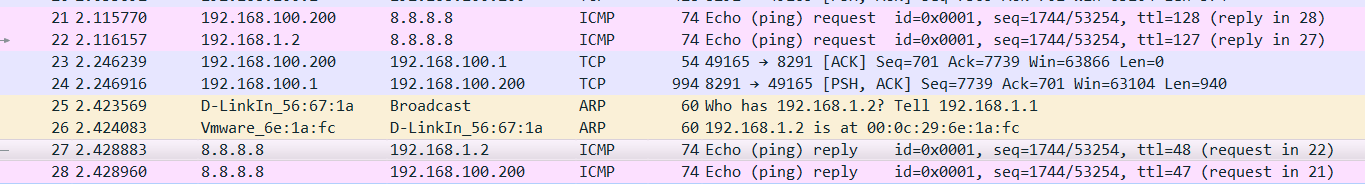

Static Nat work correctly and replace the 192.168.100.1 with 192.168.1.2 and then modem ARP 192.168.1.2 and the router response with 192.168.1.2 mac address …
but when i change To address with any other ip in network 192.168.1.x it Static Nat correctly work and replace 192.168.100.1 with that ip But when Modem ARP the ip to resolve the mac address it doesn’t receive any response.(I Attached the pictures)
so changing the ARP setting isn’t logical,true ?
as a result My NAT Rule was correct,and in these case :
When setting to-addresses on src-nat, it has to be one of router’s own addresses being directly reachable by upstream hop (in your case that’s modem)
and this is a necessary rule ?is it true ?
