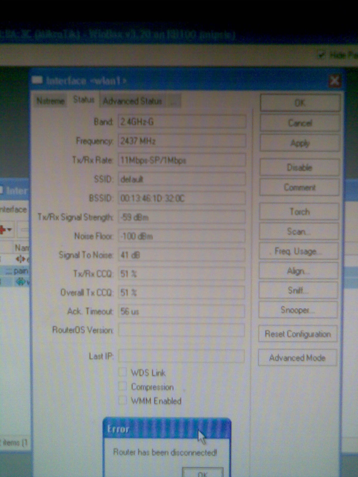

Thanks Normis… think i have the cpe connected to my access point (dlink) ssid is default not dlink, changed that in the script, here’s a screen shot… I have an internet connection on the dlink which i can access wirelessy with a pci card built into my pc when connected to the dlink, however i cant get on the internet with the rb112. Its connected to ethernet port on my pc. perhaps my pc settings are not right… maybe you can suggest what they should be?
  1. I see you are using the MAC address to connect to your router, that’s not right, use the IP unless the device doesn’t have it yet. Connect with Mac, add an IP and then connect with IP, the connection to winbox will be more stable
  2. If internet can be pinged from the router, and the router can be pinged from the client pc, then you need a masquerade rule in the src-nat chain, see more:
http://wiki.mikrotik.com/wiki/Basic_Installation_of_RouterOS
http://wiki.mikrotik.com/wiki/How_to_Connect_your_Home_Network_to_xDSL_Line
http://wiki.mikrotik.com/wiki/MikroTik_RouterOS_Frequently_Asked_Questions_-_FAQ#TCP.2FIP_Related_Questions
