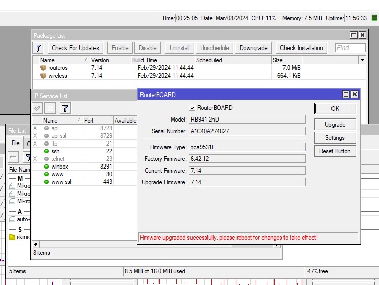

i ran it with lastest 7.14 with hap lite, FYI
include:
wireless package
dual wan failover ECMP scripts
NTP server
graphing
no facy stuff inside.
The behaviour with =S7 is unexpectable, 60% of time I just receive 62byte from it (wireguard status), other times it works ok. It’s not depending on exernal facts, it depends by it only, probably the CPU goes sometimes 100% for no reasons (nobody is connected to it, there are no filter rules as it’s behind another router), I have only a safe OVPN channel to manage it in case they changes the WAN IP, but it’s just answering keepalives.
I’ve installed 14.1 and I’ll check with it, by the time I still wonder to know from someone how to optimize the ruter.
EDIT; I’ve seen now your screenshot, you gacv me the idea to disable api, telnet, web, and all things I don’t use, let’s see
