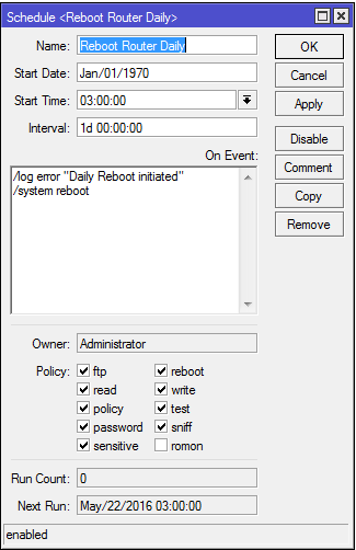

I have a few scripts but none act the way this one does. The desire is to reboot the router device once every day at 3AM. Seems simple but it has caused some undesirable oddities that I am unable to figure out.
Here is the script:
/system scheduler
add interval=1d name="Reboot Router Daily" on-event="/log error \"Daily Reboot initiated\"\r\
    \n/system reboot" policy=ftp,reboot,read,write,policy,test,password,sniff,sensitive start-date=jan/01/1970 start-time=\
    03:00:00

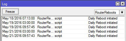

What I am seeing is the day I add the script, it executes as expected but that is when normal expectation ends. Even though the “Next Run” field shows the next expected run time, it will skip this time and only execute every other day.
Then the strange thing happens, the script executes an unscheduled time during the day, also every other day after the scheduled reboot occurs.
While, I would like to know the answer as to why, I can live with the every other day problem but rebooting at 9:57 in the morning, just as the office starts doing its daily business has become a sore point. If anyone can chime in and help me figure out where this extra reboot is coming from, I would be most appreciative.
This is an x86 device running v6.35.2(stable) just recently upgraded from 6.35(stable) in hopes to resolve this as a stray bug with no luck. The device is an i7 CPU with 8 cores 3.4GHz and 2GB RAM. Storage is 120GB SDD.

Also to add, I have looked in both WinBox and Webmin at the scheduled tasks and there only appears to be two tasks scheduled, the one I have shown and one other which runs hourly. The hourly task works fine. I cannot find anything which is causing the 9:57AM reboot of the router but I can assure you it is happening on a schedule of every day which is new of just the past few days and I do not know where else to look to eliminate that one.
