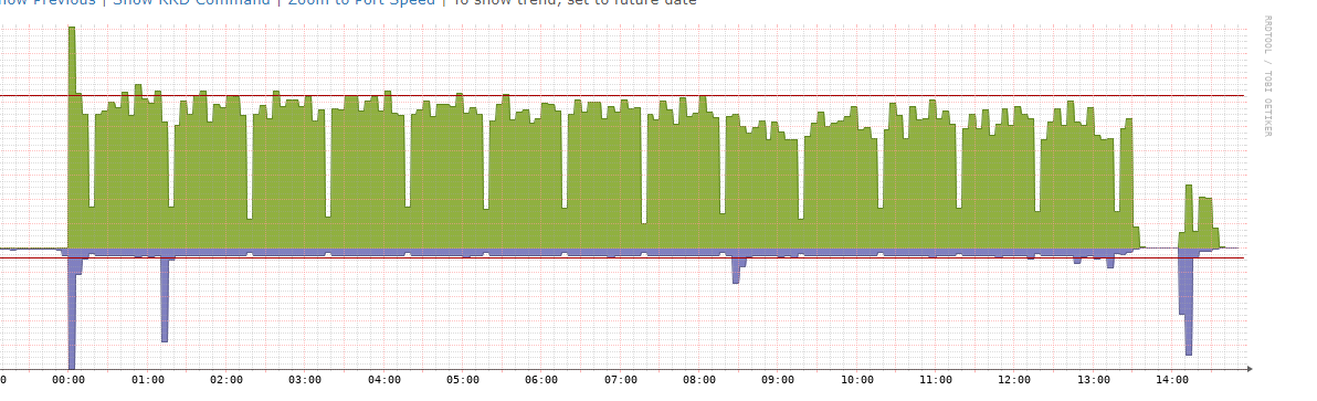

Both go from full speed to allmost no speed, every hour from 15-19 ?
So 24 times a day from 300mbit to 0.3mbit !?!?
On both 2.4 and 5ghz.

Hourly dip in thoughput

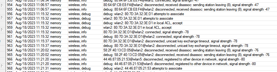

Log part
