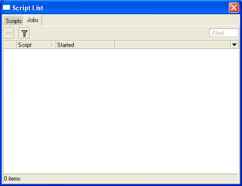

I’ve noticed with WinBox (and RouterOS 4.3 on my RB750G) the Jobs tab in the System: Scripts Lists aren’t showing any scheduled jobs and neither does it allow me to add new ones.
When using the terminal, the scheduling is working just fine.
Anyone else experiencing the same or know of a fix for this?

I don’t see the point in trying different examples, if the Jobs tab doesn’t even have a button to add new Jobs :frowning:
Here’s my simple scheduled job (which already ran as you can see) and my simple script:
 /system scheduler> print detail
Flags: X - disabled
 0   ;;; Test Script
     name="Test" start-date=dec/14/2009 start-time=17:04:00 interval=10m on-event=set-local-routes owner="admin"
     policy=ftp,reboot,read,write,policy,test,winbox,password,sniff,sensitive run-count=1 next-run=17:14:00
/system script> print from=set-local-routes
Flags: I - invalid
 0   name="set-local-routes" owner="admin" policy=ftp,read,write,winbox last-started=dec/14/2009 17:04:00 run-count=1
     source=:log info "Success"
I’ve uploaded a screenshot of the blank Jobs list.
‘Jobs’ is ‘currently running tasks’, not ‘planning soon’ =) you won’s see anything here until script actually executes
