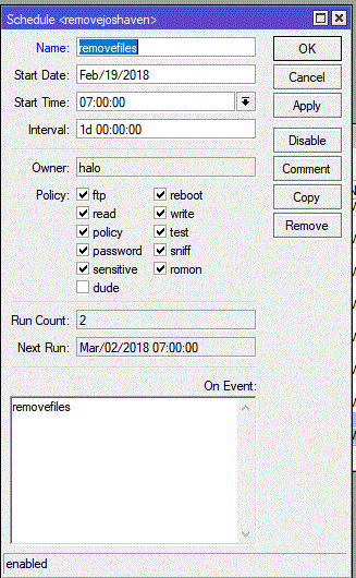

Question: Scheduled event will not work at time slot selected – WHY?
The script work if I manually invoke it but the Scheduler will not fire it at time selected – WHY?
Script:
/file remove [find name="spamhaus.rsc" or name="dshield.rsc" or name="malc0de.rsc"];log info "Remove  Joshaven files"
the Scheduler:
What policies are set for script?
The pictures I posted show the polices ??? is there some other policies I should be aware of?
I have 8 other scripts that I have the scheduler run and they all work just fine … why the one I posted about does not fire by scheduler ???
Try it with in the On Event box.
/system script run removefiles
@msatter
Thank you for the workaround … your suggestion worked.
When you tested it manually you where already in the “/system script” menu section so the “removefiles” is selectable.
When a schedule is executed is not in the /system script section so the schedule does not find the script.
