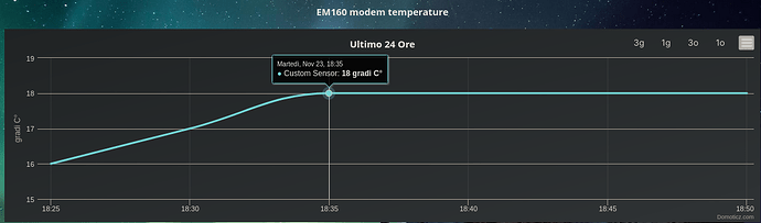

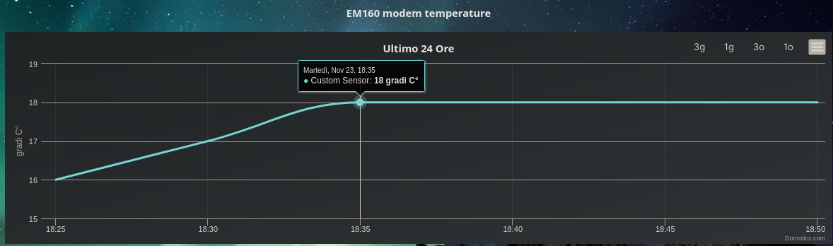

I solved by forwarding port 8443 !!!!
script on the LTE router and should be scheduled every 4-5 minutes
#temperature read by another script
:global temp2
#temp value transfer to domoticz on idx27 through NAT port 8443
:global url "https://192.168.x.x:8443/json.htm?username=user&password=password&type=command&param=udevice&idx=27&nvalue=0&svalue=$temp2";
/tool fetch keep-result=no url=$url mode=https
#forwarding rule on the main router
/ip firewall nat add chain=dstnat dst-port=8443 action=dst-nat protocol=tcp to-address=10.100.0.202 to-port=8443
