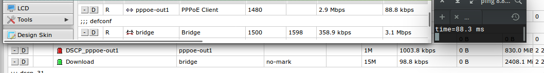

I reduced the Max-Limit to 1M but still ignores it and downloads it to 3M as you can see from photos.

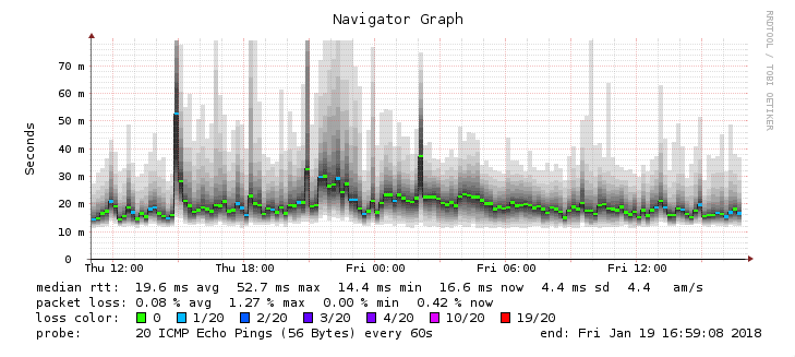

  • Here’s the 8.8.8.8 ping at 30 hours of my lan even when it’s congested it stays always low finally!!
Lol, nice try though :wink:.
Nice graph
