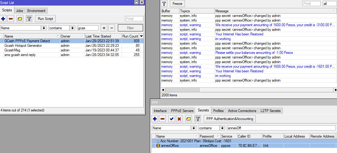

Script issue, 0 value turns to be false value?
Hello again sir, Im having a hard time working on this project. my problem is, even the comment “Counter” is equal to 0 “Zero” the log shows that it has to be paid, and also if you paid not equal to the “Counter” it displays as balance and also needs to be paid, what could be wrong in my code? please do help, thankyou!
:local newMess   "You have received PHP 1600.00 of GCash from JO*MSG: 2021001. Your new balance is PHP 1649.00. Ref. No. 3007882128690."
:local amount [:pick $newMess ([:find $newMess "PHP "] + 4) [:find $newMess ".00 of GCash"]]
:local sender [:pick $newMess ([:find $newMess ". "] + 2) [:find $newMess  " w/"]]
[/ppp secret set "annexOffice" comment=$newComm]
:if ($cost <= 0) do={
	:log warning "We receive your payment amounting of $amount.00 Pesos, your credit is $total.00 Pesos your account will be now re-activated"
	[/sys scr run [find name="annexOffice"]]
} else={
	:log warning "Please settle your balances amounting of $total.00 Pesos"

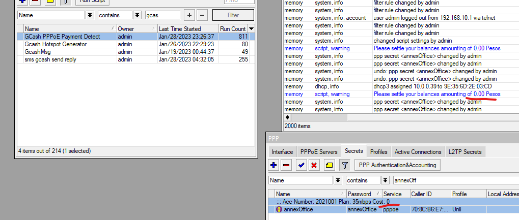

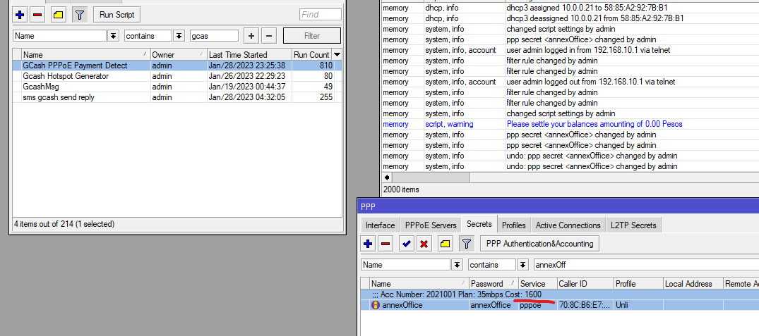

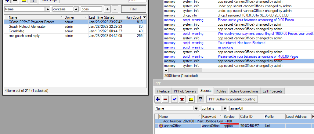

My problem is, when “Cost” counter hit zero or negative amount , it logs that i have remaining balance of 0.00 Pesos. i do want to log it as “Payment receive your account is now activated” it balance is = equal to zero or -negative amount
