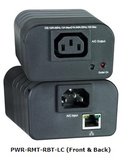

Here is the solution for you:
http://www.networktechinc.com/control-power.html#tab-5
Connect this power adapter on the power for the modem. Then set it to auto ping an IP address.
If ping stops, then the adapter power cycle the modem.
I know about similar items. Problem is that the modem has battery that lasts for 6 hours.
When I said unplug power, that included pulling out the battery. It will not power on if battery is not installed.
