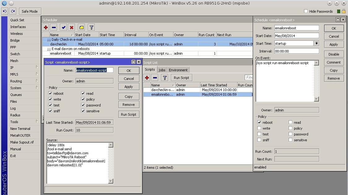

I have included a jpg screenshot of the setup just in case you spot something I haven’t done.

Put there a simply log message only inside the script to test it is running or not.
Use only script name in sheduler on event. Nothing more. And enable all policies.
Thanks Jarda, the last bit you advised has worked and ran just a few minutes ago after I set it and rebooted the router. Now to roll it out to all of my MikroTik babies :slight_smile:
So setting all the policies to being ‘ticked’ and just putting the script name (emailonreboot-script in my case) in the “On event” section without the “/sys scripts run” bit worked perfectly.
