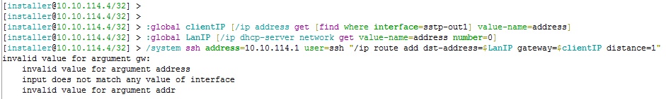

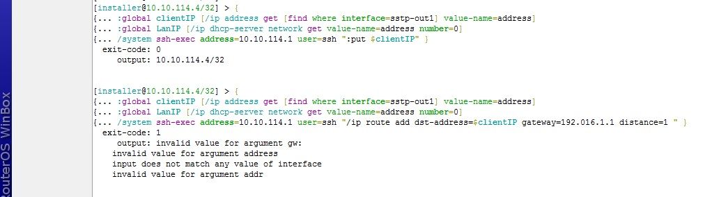

I managed to log in to the second routerboard but I have problems entering data using the variables … I try to post a screen, maybe someone can help me
Variables are ok, they just need to have correct values. In this case the address, which you use for gateway, needs to have mask stripped from it. This works for me as system script:
:local addr [/ip address get [find where interface=test1 disabled=no] value-name=address]
:set addr [:pick $addr 0 [:find $addr "/"]]
:local lan [/ip dhcp-server network get value-name=address number=0]
/system ssh-exec address=192.168.80.181 user=testadmin "/ip route add dst-address=$lan gateway=$addr"
Getting it to work as script executed by VPN client is another challenge, because if I remember correctly, it runs under some system account and you can’t add ssh key for it. Maybe it can work if you wrap it in system script, where owner user has a key, I’m not sure.
In any case, the whole thing looks incredibly insecure, because you’ll have to give clients admin access to server. It also won’t work well, if you don’t have all clients and their routers under your control, because half of them will have some same popular LAN subnet like 192.168.0.0/24.
therefore, the login takes place … I do not use a key because that username is accessible only from the VPN subnet, but I could also use a key if necessary … the clients will be many … but this is the idea, to create a conf in which the user inserts the variables of the ip classes in the head and when he then launches the script this script will be activated which inserts the route into the server … if you look carefully, I am entering the dst-address of the 10.10 classes. which will all be different … so with the first variables of the script the correct data are imported which are in this case dst-address 10.10.110.0/24 and gateway 10.10.114.4 … if I indicate the ip in the route after login, the route is created correctly on the server … if I use variables no … how would you change this?
As I wrote, the script works for me, even with variables. The problem I had with your original one was IP address it got from “/ip address”, because it contains netmask. Even if it’s single address, it still has /32 mask appended, and that can’t be used as value for route’s gateway. After I stripped the mask, it worked.
