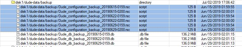

I am not very au fait with Mikrotik Scripting, and not sure if the problem is with Scheduler in CHR or if script is incorrect, so if someone does not mind helping me out here it will be much appreciated.
What I have is a script to backup Dude config and database (On CHR), but it seems to be creating duplicate backups, see screenshot below
When I run the script via /system script, it works fine, but with scheduler, duplicates?
/system scheduler
add interval=1w name="Dude Backup" on-event="/system script run backup-dude-locally\r\
    \n" policy=ftp,read,write,test start-date=dec/01/2018 start-time=02:00:00
