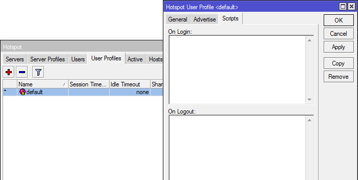

What you are asking should be possible. A few questions:
Do you use the User Manager with the hotspot? I don’t know if this would affect the process… but it might.
Is your hotspot set up so that you are able to use the On Login / On Logout scripts under User Profiles? This would probably be the way to do it…
Once the users are logged in the first time, this record will need to be stored somewhere. How long do you want this record to exist? 1 month, 1 year?

If you put this script in the On Login box (picture earlier), do you start seeing logs of users logging in?
/log info "$user just logged in, triggered On Login script";
Also, do active hotspot users show up in IP > Hotspot > Active tab?
yes, “user just logged in, triggered On Login script” pops in the log when someone logs in
and yep, everything show in the active taps

   :local time [/system clock get time];
# get user IP
   :local ip [/ip hotspot active get [find user="$userStr"] address];
# delcare a few variables
   :local emailsubject;
   :local emailbody;
# if user does NOT exist in Address List
   :if ([:len [/ip firewall address-list find list~"^$userStr - HSLOGIN"]] = 0) do={
      /log info "[HOTSPOT] - $userStr - not found in Address List";
# add firewall rules that will add dynamic address list entry
      /ip firewall filter add action=add-src-to-address-list address-list="$userStr - HSLOGIN,$date,$time" address-list-timeout=$timeout chain=pre-hs-input disabled=no src-address=$ip comment="$userStr - HSLOGIN";
      /ip firewall filter add action=add-src-to-address-list address-list="$userStr - HSLOGIN,$date,$time" address-list-timeout=$timeout chain=forward disabled=no src-address=$ip comment="$userStr - HSLOGIN";
      :local counter 0;
# number of times to attempt to add user to Address List before giving up
      :local limit 60;
# delay between attempts
      :local delaytime 5s;
# loop a number of times to check if user is added to Address List
      :while (counter < $limit) do={
         :set counter ($counter + 1);
         /log info "[HOTSPOT] - $userStr - checking if user is in Address List - attempt $counter of $limit";
# wait between Address List checks
         :delay $delaytime;
# if Address List entry is found, proceed
         :if ([:len [/ip firewall address-list find list~"^$userStr - HSLOGIN"]] = 1) do={
            /log info "[HOTSPOT] - $userStr - user has been added to Address List, sending email";
# set email subject and body variables
            :set emailsubject "New Hotspot Login ($userStr)";
            :set emailbody "User: $userStr\r\n$time, $date\r\nIP: $ip\r\nExpires in: $timeout";
# increment counter
            :set counter ($limit+10);
         } else={
# if we have reached the limit of times to check, send email
            :if ($counter = $limit) do={
               /log info "[HOTSPOT] - $userStr - failed to add user to Address List, sending email";
               :set emailsubject "New Hotspot Login ERROR ($userStr)";
               :set emailbody "ERROR: failed to add to Address List, need to investigate.\r\n\r\nUser: $userStr\r\n$time, $date\r\nIP: $ip\r\n";
# remove firewall rules afterwards
      /ip firewall filter remove [find comment="$userStr - HSLOGIN"];
# send email
      /tool e-mail send to="$emailaddress" subject="$emailsubject" body="$emailbody";
# if user DOES exist in address list
   } else={
      /log info "[HOTSPOT] - $userStr - already in Address List";
# if user does not match name filter, log info
} else={
   /log info "[HOTSPOT] - $userStr - logged in, does not match name filter";
