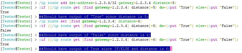

Copy and paste the following in Terminal:
/ip route add dst-address=1.2.3.4/32 gateway=1.2.3.4 distance=5;
:if ([/ip route get [find gateway=1.2.3.4] distance]=5) do={:put "True"} else={:put "False"};
##Should have output of "True" since distance is 5;
/ip route set [find gateway=1.2.3.4] distance=6;
##Should have output of "False" since distance is 6;
:if ([/ip route get [find gateway=1.2.3.4] distance]=6) do={:put "True"} else={:put "False"};
##Should have output of True since IF/ELSE and distance is 6;
Should look like this!
Indeed this works on my main Mikrotik, but not on the other one.
When running this , i get “invalid internal item number”
