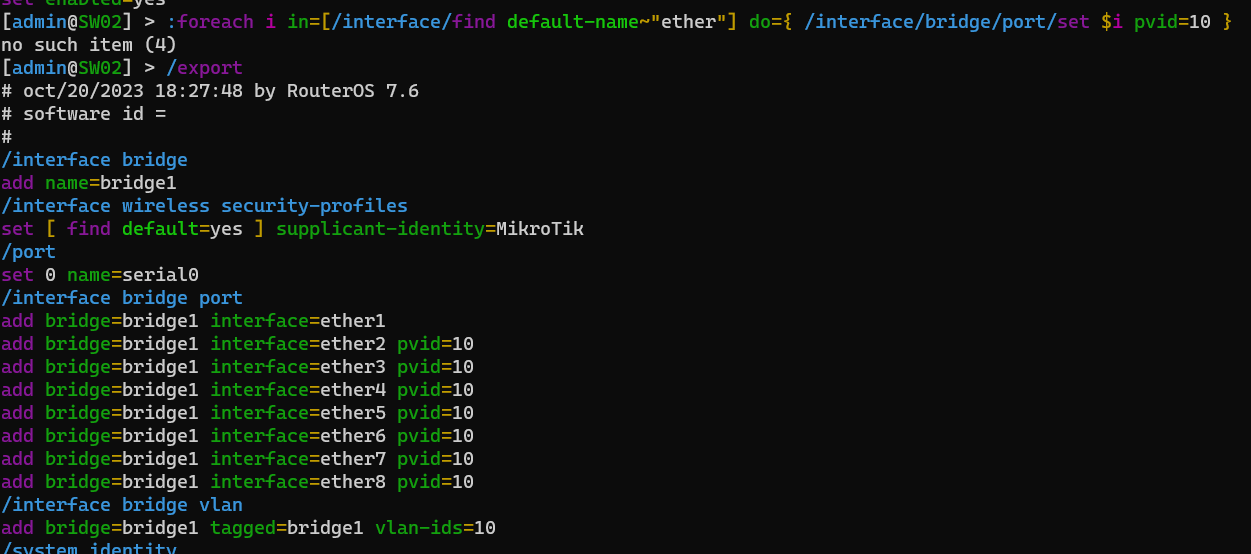

Working on an initial configuration script that can be uploaded to a switch through winbox and applied upon reset of configuration. The script has some variables at the top to build out the vlan database, settings and so on. Everything in the script works except adding the pvid to the ether ports. There is some strange behavior on a selector, but only when its being used with a set on the port command.
Lines 59 and 60 work as expected and assign the ports to the bridge.

Lines 68 and 69 uses the same selector, but skips “ether1” and includes “sfp-sfpplus1”
# Configure Access Ports
:if ($ConfigAccess = true) do={
    :foreach i in=[/interface/find default-name~"ether"] do={ /interface/bridge/port/set $i pvid=$AccessVLAN frame-types=admit-only-untagged-and-priority-tagged }
Hardware I’m testing on is a CRS328-24P-4S+ running 7.11.2 with the firmware matching. I have attached the script if anyone is interested.

I tried it in EVE on an older firmware 7.6 with the same behavior. Skipped ether1. So I am missing something . . . .
NOTE: entry “.id” have nothing to do with VLAN ID
The script is a vomit, very mess, entry “.id” of VLAN is mixed with the entry “.id” of the interfaces, etc.
:foreach i in=[/interface/find default-name~“ether”] do={ /interface/bridge/port/set $i pvid=$AccessVLAN frame-types=admit-only-untagged-and-priority-tagged }
foreach entry id of interface, set on bridge port the random item that for coincidence have same entry id… etc.
The correct way is something like this:
:if ($ConfigAccess) do={
:foreach ifIndex in=[/interface find where default-name~“ether”] do={
:local ifName [/interface get $ifIndex name]
/interface bridge port set [find where bridge=$BridgeName and interface=$ifName] pvid=$AccessVLAN frame-types=admit-only-untagged-and-priority-tagged
I suspect the “:if ($ConfigAccess = true)” is the cause… if $ConfigAccess is not defined with a type of bool, that won’t work. Note the difference in @rextended version where it will “cast” any type to a bool vs explicitly looking for boolean “true” in the variable.
