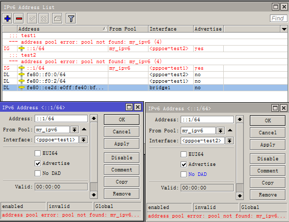

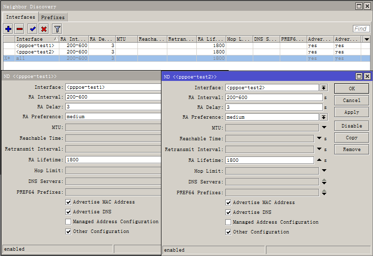

As shown in the attached figure, when a PPPOE user is online, ipv6 address & ipv6 ND will be added automatically, and when the user is offline, the corresponding added classes will be deleted, how to write such a script?

I built a PPPOE SERVER on the intranet and assigned IPv6 address prefixes through PPP. When the client connects to the server, I envision automatically adding addresses and notifications to the corresponding dynamic interfaces on the server, as shown in the attached image (except that I manually added them), and automatically deleting them when the client goes offline. As far as I know, ROS doesn’t seem to have this feature yet.

As you can see in the picture below, but you can’t add a comment in the /ipv6 nd menu, and you can’t delete it when the client is offline.
RouterOS just through the PPPOE distribution IPv6 prefix, the computer through the dial-up connection to the PPPOE Server, and can not get to the IPv6 address, which is to use the script to add, delete the dynamic interface address and nd reason.
