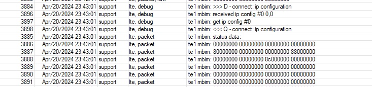

There is anther problem… that needs a different solution. I already mentioned about this problem and also reported to support
and this is the same problem here blow
This evening there was no LTE interface in the list!!!
The stick is inserted, of course, in the USB port, the red led blinks (means: 4G available, not cooected).
of course I can not enable\disable somthing that according to the ROS does not exist.
Trying USB power reset… no effect
I had to reboot the RB5009.
As I said, I reported this to support with several logs and the answer is: your LTE stick is faulty.
I do not agree since it works fine in the other 2 Linux based routers
Moreover, have a look at the path:
a) start from a freshly booted RB5009, with the LTE stick plugged
b) after hours or 1 day or 2 days… it is not predicatable… the LTE disappears from interface list
c) USB power reset, no effect
d) unplug the LTE and plug it again, NO EFFECT !!!
f) ok let’s do this now:…
g) unplug the LTE
h) plug a stipid USB pendrive, RB5009 DOES not see anything attached to it
i) reboot the RB5009… everything again is OK
According to me, step d) and h) are the proof of that there is something strange in the RB5009
