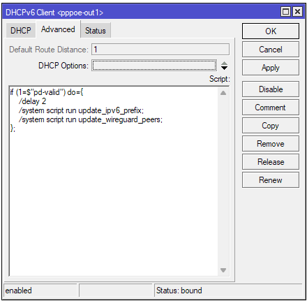

A possible workaround might be to have a script on the DHCPv6 client entry, that checks whether the $“pd-valid” is no longer 1, and in that case disable the IPv6 ND entry for bridge0 for 1 second and re-enable it. That might trigger a RA immediately on bridge0 when pppoe-out1 is down. Description for the script property is here (script in my screenshot is unrelated, yours should check for (1!=$“pd-valid”)):
https://help.mikrotik.com/docs/display/ROS/DHCP#DHCP-DHCPv6Client
Or a script that performs the same action can also be attached to the on-down event of the PPP profile that pppoe-out1 uses (you can add a separate PPP profile, assign the script to on-down, and specify pppoe-out1 to use this profile)

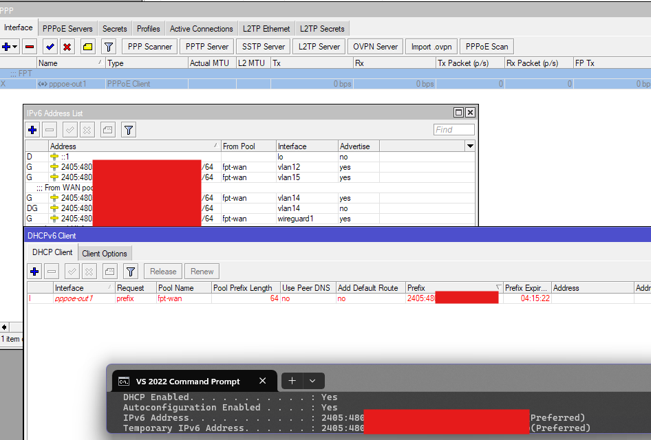

I just tested, and unfortunately what I wrote above won’t work. It appears that when the PPPoE out interface is disabled, the DHCPv6 client entry is shown as red, as expected. But the pool is still there and the addresses assigned to the bridges/vlans are still all active. On the clients, the address is still marked as “Preferred”. It will be the case until the prefix expires in DHCPv6 Client
What needs to be done is to disable the DHCPv6 client entry with the script too. Then the addresses will become invalid (red) and deprecation messages are correctly sent, on the clients the affected addresses are marked as deprecated immediately.

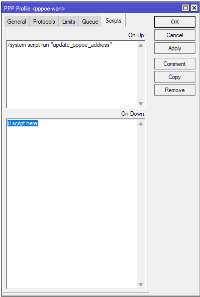

I’ve never test to see if setting the “on-down” value directly with the name of the script like you wrote would work. Usually, I put something like
/system script run "ppp-on-down"
in the box. See my screenshot where I put the call in the “On Up” event.
Also according to my test above, it’s not necessary to disable-then-enable the ND entry, it was sufficient to just disable-then-enable the DHCPv6 client entry.
And instead of changing the on-down event of the “default” PPP profile (that profile might be used by other PPP configurations, including SSTP for instance), you can try to make a copy of that "default’ profile, change the on-down event on that profile, then edit pppoe-out1 to use that newly created profile instead of default (again in my screenshots above I’ve made a pppoe-wan profile and used it in pppoe-out1).
