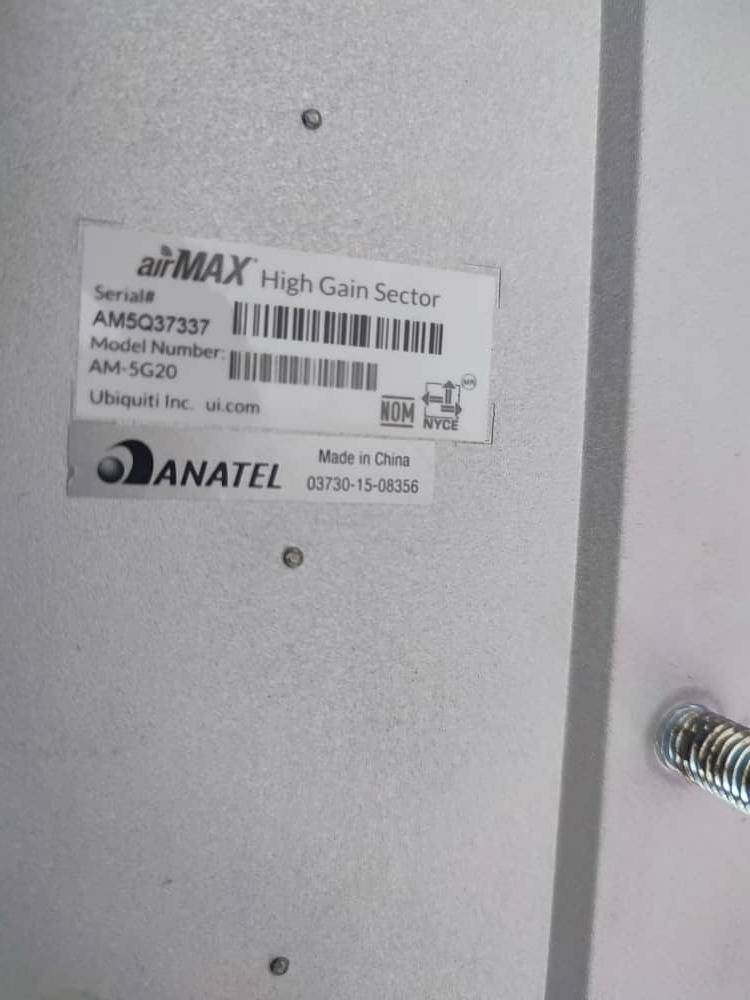

please i am having a challenge with three devices. one set of the device is ubiquiti am 5g-20 sector antenna with a base box 5 (rb912uag-5hpnd
) connected to it… which is setup as an Ap bridge on the client end is an LHG 5…

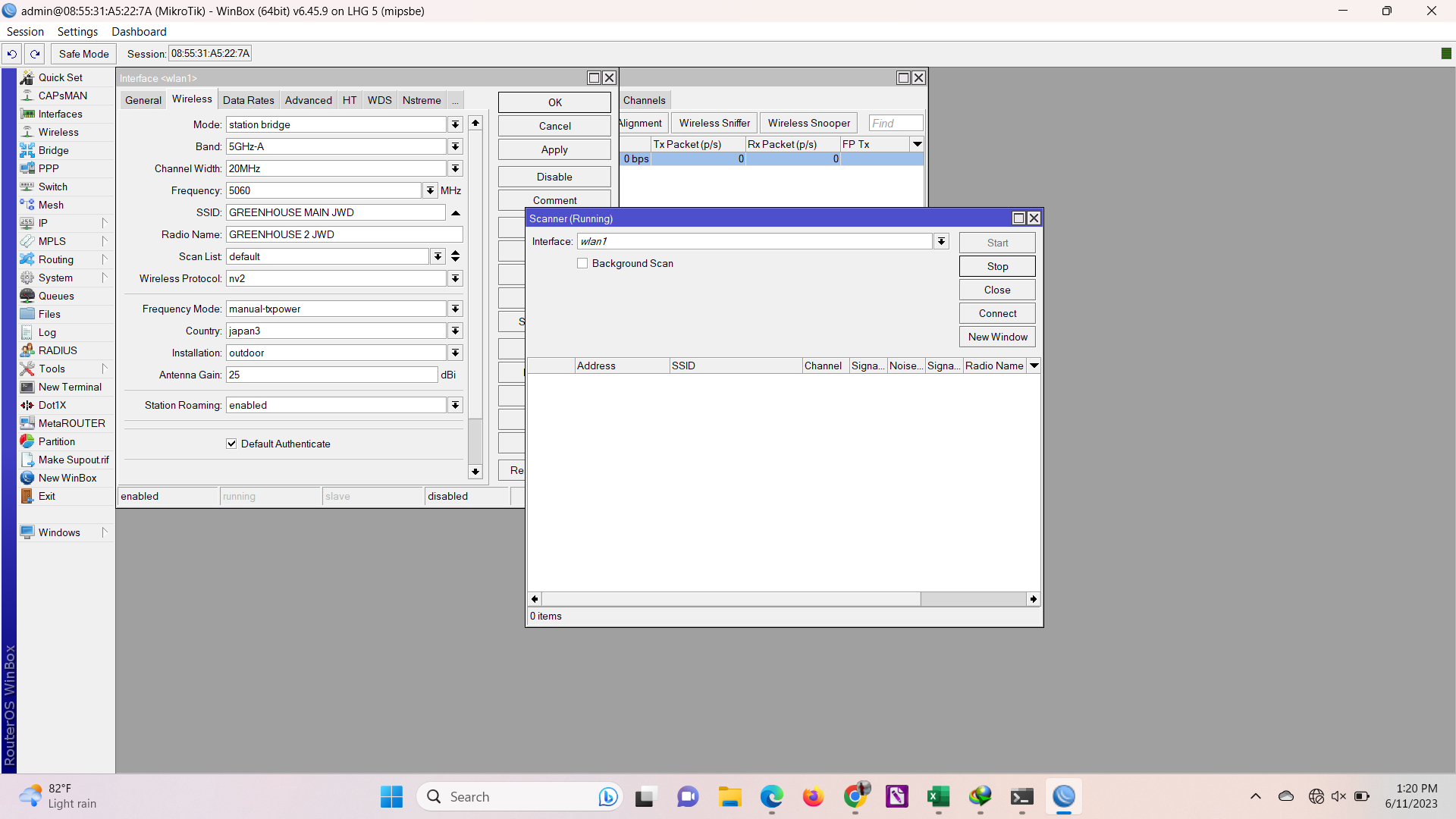

now after setting up the sector and base box in ap bridge mode and the LHG in station bridge mode. at very close range of about 100metres…the lhg doesnt pick up the ssid, seems like the sector antenna is not broadcasting..

You may need to configure a scan-list, or something may be incorrect on the AP

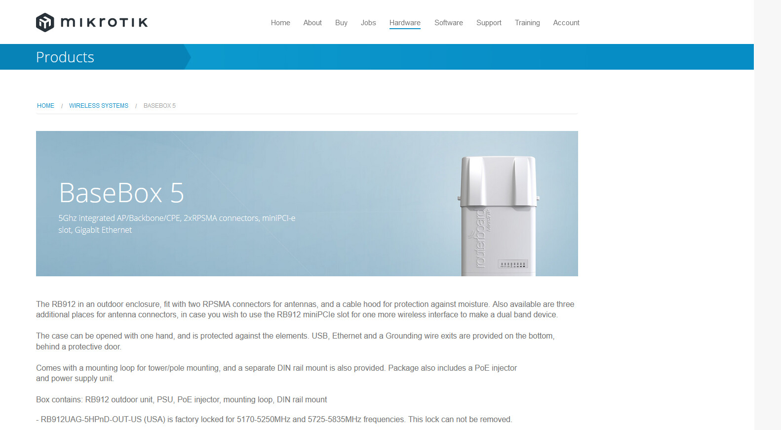

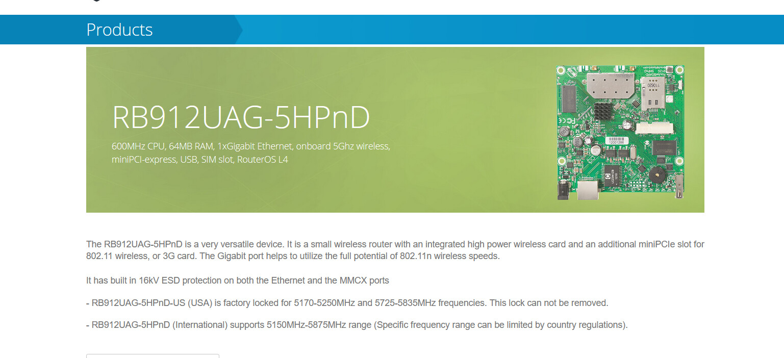

According to the LGH5 product page it does not support 5060MHz as a valid frequency.
According to the rb912uag-5hpnd product page it does not support 5060MHz as a valid frequency. :laughing:
thank you for your feedback sir, i use this same frequency for a point to point via lhg to lhg
thank you for response, is there any difference btw the rb912uag-5hpnd and base box 5. i noticed they have two difference product pages. because i have used this same antenna with a base box 5 and it works fine…

Usually this is because the client and access point’s WIFI parameters do not match. Unfortunately my IT tambourine is on an upgrade, and without it I can’t determine what they don’t match only by the client settings. :smiley:
PS
You have a default list of scanned frequencies set on your client. As it was written above, the frequencies 5150-5850 are scanned by default.
Set LHG:
band - 5GHz a/n
wireless protocol - any
scan list 5000-5250
