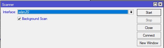

Show me a scan of the airwaves without NV2 and with it.
You need to scan with the device itself, not a separate one.
