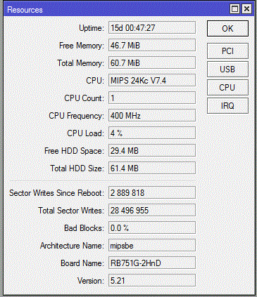

I’ve got a RB751G-2HnD and after 15 days of uptime I’ve got 714 393 sector writes.
I see around 8.3 sector writes per second (on average). This is around 500 writes per hour. This 751G is used only as a basic AP for about 4-5 clients. I have not seen the high flash utilization yet, but this is more utilization than my 450G with graphing enabled.

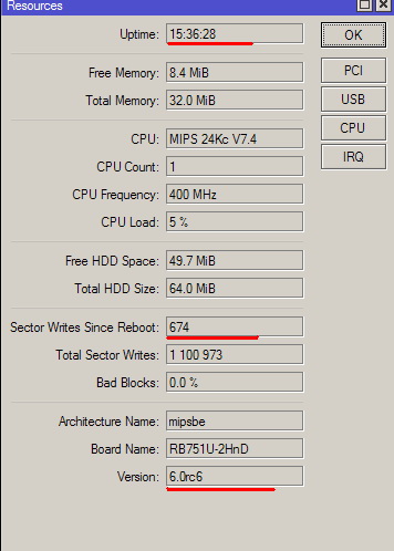

I had a similar problem on devices RB751 and RB2011.
The problem was resolved after the upgrade all devices to version 6.0 Rc6 firmware - 3.02. Updating is done using netinstall.
Writes to disk reduced very good!
