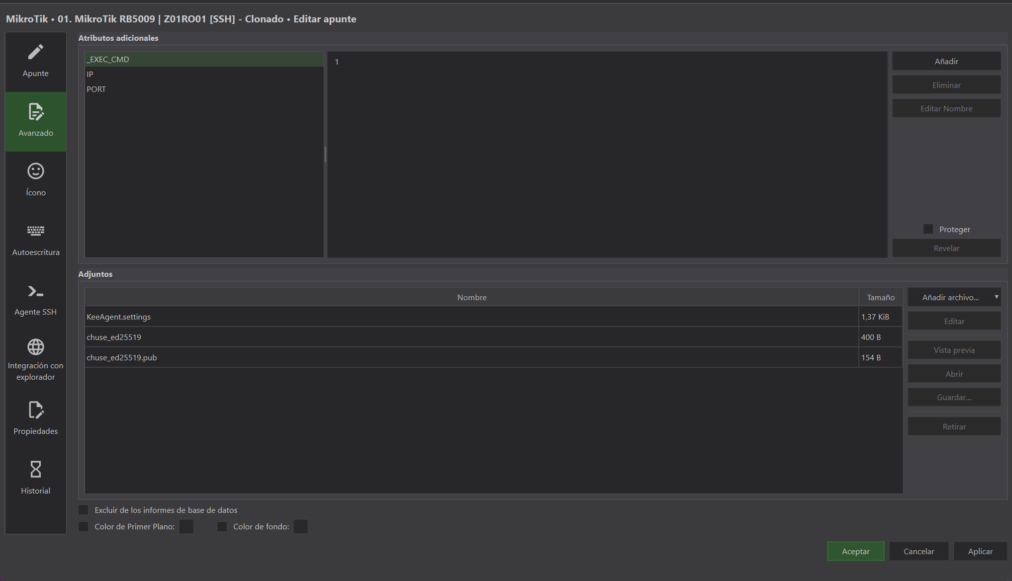

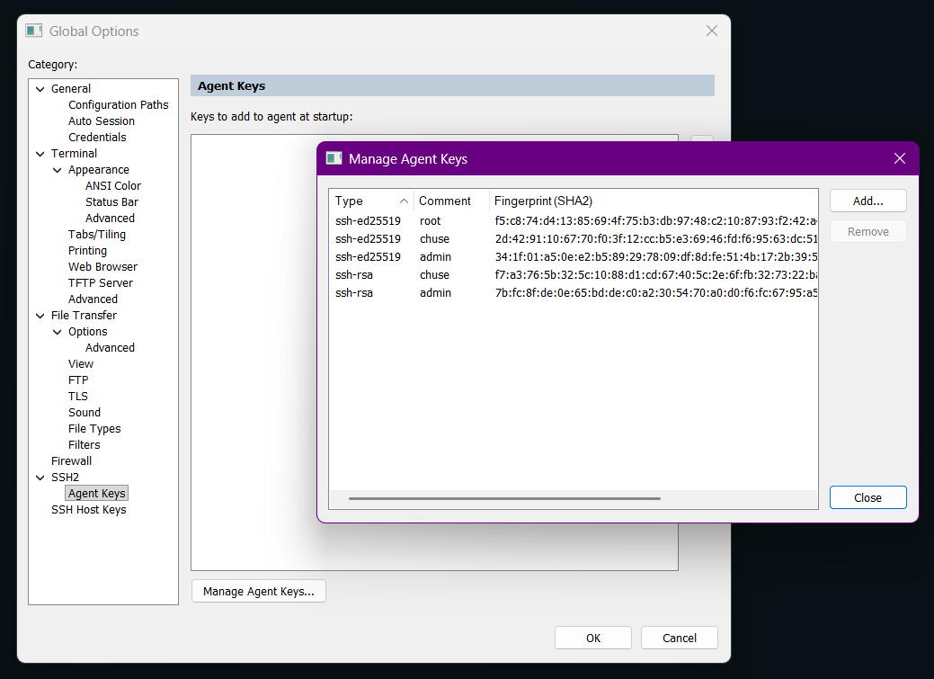

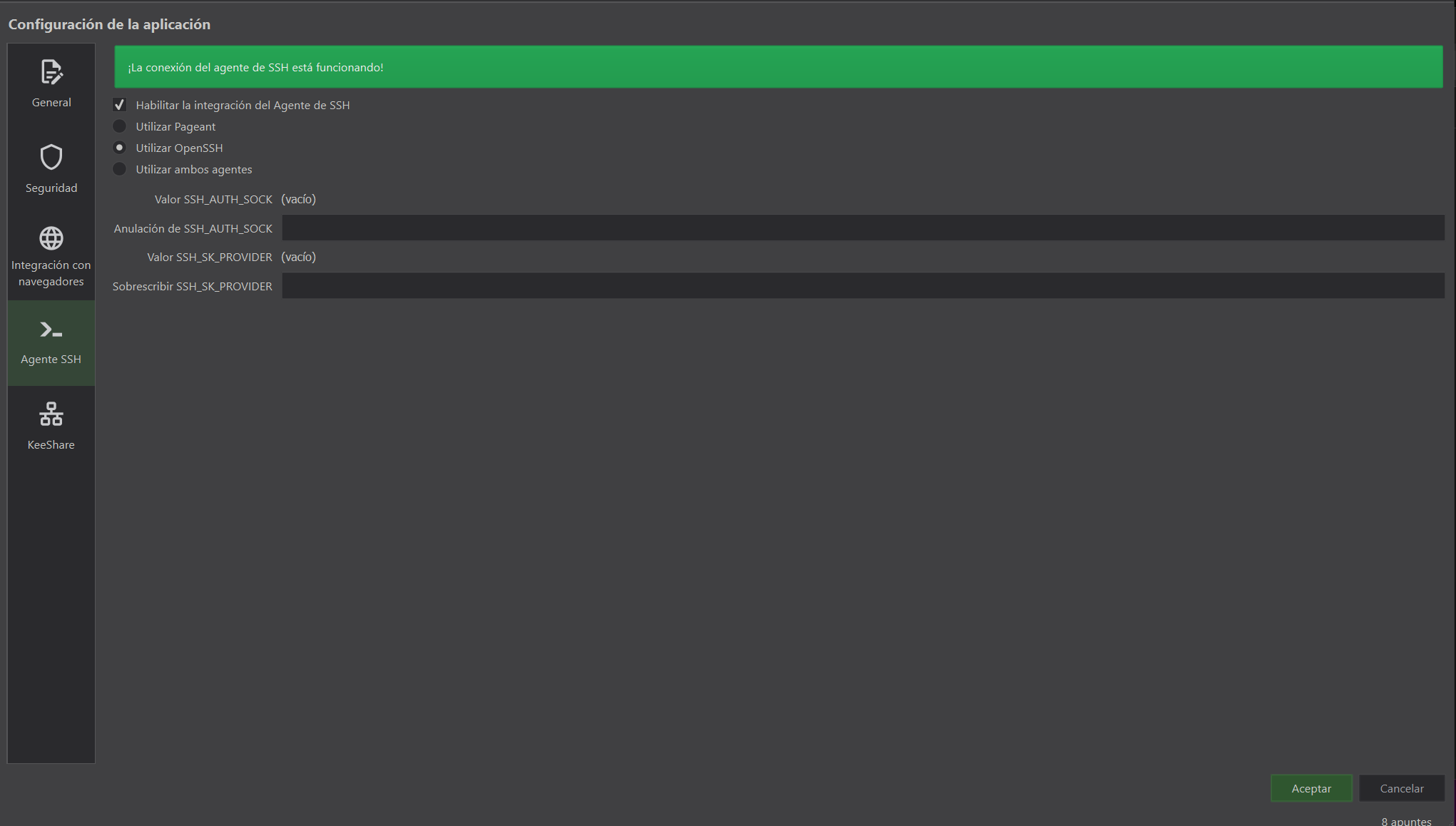

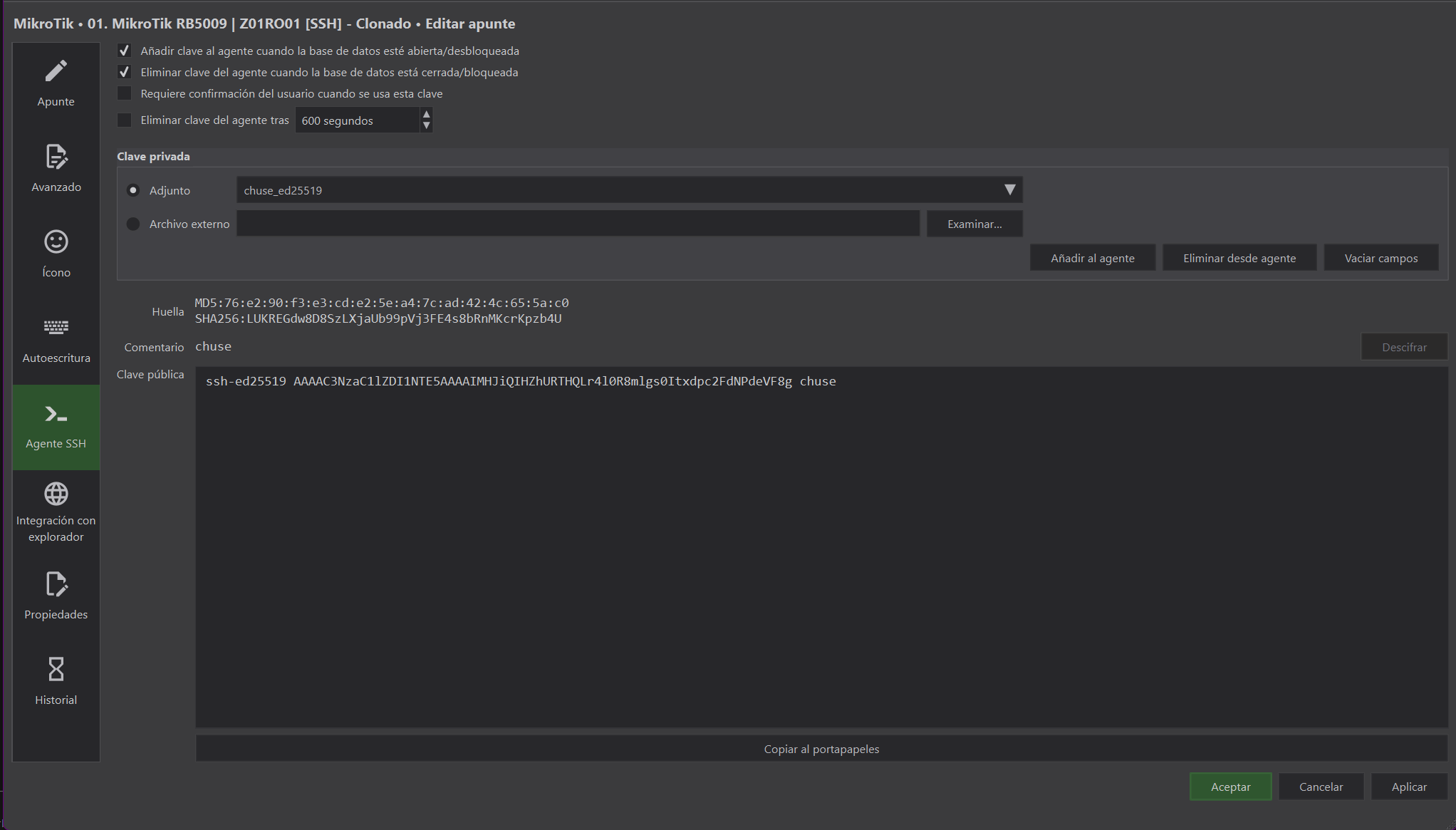

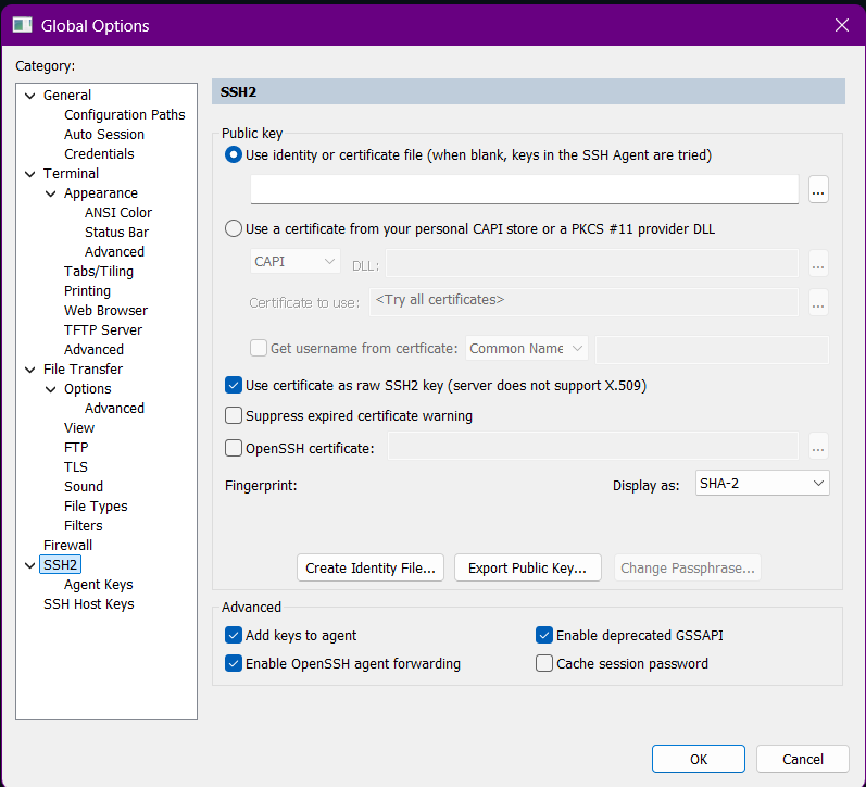

I'm using KeePassXC to manage SSH keys and launch SecureCRT sessions via a cmd:// URL. The flow is: KeePassXC unlocks → injects the private key into the Windows OpenSSH Agent → SecureCRT reads the key from the agent and authenticates. VANDYKE_SSH_AUTH_SOCK is set to \.\pipe\openssh-ssh-agent.
THE WEIRD PART
Everything works perfectly with RSA 4096 keys — both against Ubuntu servers and MikroTik routers. But with Ed25519 keys, it only fails against MikroTik. Same Ed25519 key against Ubuntu: works fine. Same Ed25519 key directly from the Windows SSH CLI (ssh -i): also works fine against MikroTik.
So it's specifically: Ed25519 + SecureCRT (launched from KeePassXC) + MikroTik = fails.
I tried generating the Ed25519 key with -Z aes256-cbc and also with no passphrase (-N ""). Same result either way.

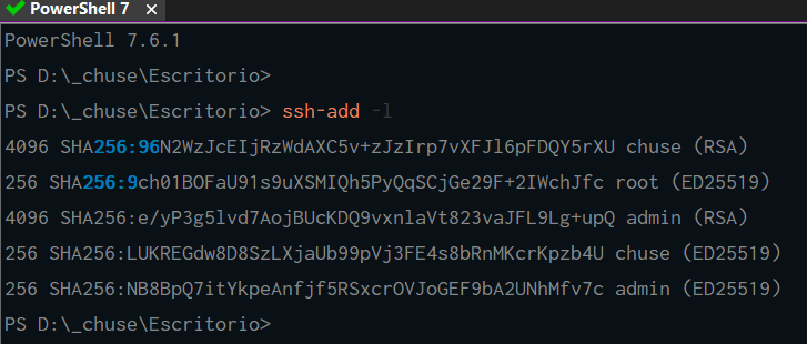

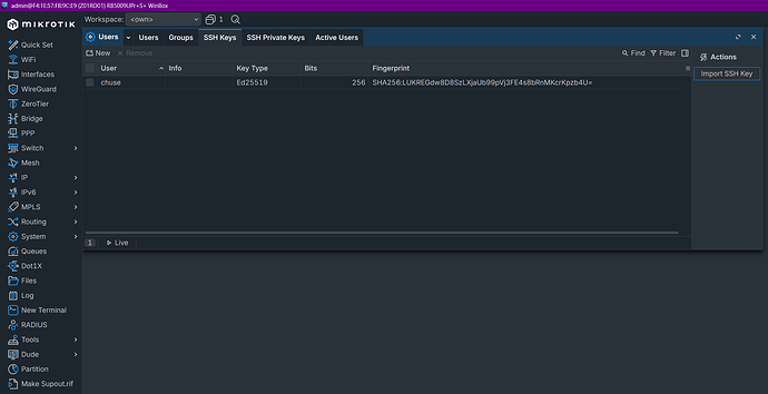

The key is correctly loaded in the agent (ssh-add -l shows it), and it's correctly imported in MikroTik (/user ssh-keys). MikroTik SSH logs show nothing when the failed attempt happens — it's like the connection just drops silently.
The KeePassXC URL I'm using:
cmd://securecrt.exe /T /N "{TITLE}" /SSH2 /L {USERNAME} /PASSWORD {PASSWORD} /ACCEPTHOSTKEYS /AUTH publickey,password {S:IP} /P {S:PORT}

It might be something in how SecureCRT negotiates the key algorithm with RouterOS when pulling the key from an external agent — maybe it's not advertising Ed25519 properly, or RouterOS is pickier about the signature algorithm format. But I'm not sure.

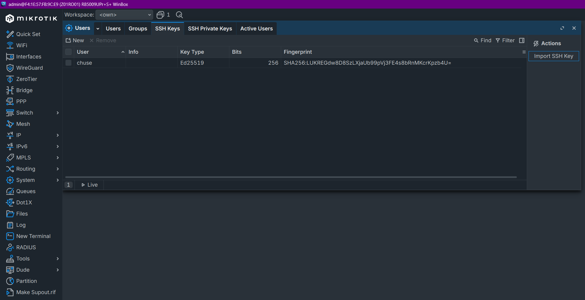

Here are a few screenshots of the configurations…
