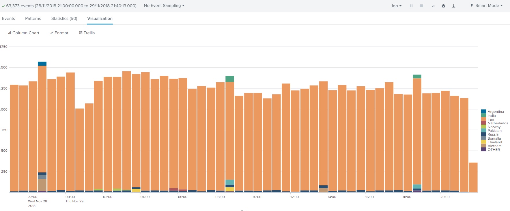

This is our company firewall last 24 hour. 65000 hits on port 8291, mostly from Iran (50 different IP in Iran)
And its on top of our list of port tried to enter.
