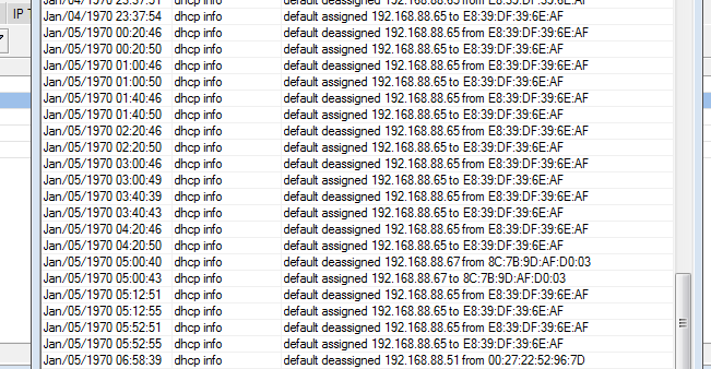

I also around this time checked the log and noticed at varying intervals the router would deassign her ip then seconds later reassign it back. this would happen over and over again seconds apart for some time. at other times it would deassign and reassign every 40 minutes (nearly exactly 40 minutes, differing only by seconds).

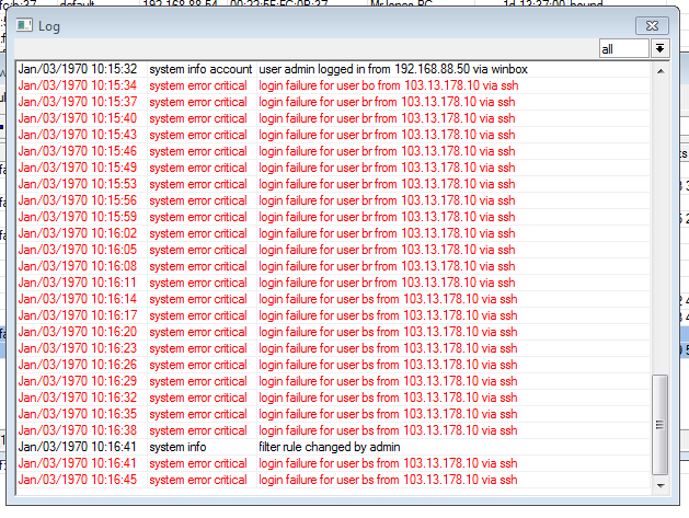

during the time I was trying to discover the cause one time I checked the log I had dozens or hundreds of entries in the log of critical errors due to failed log in over ssh it looked like a brute force attack. I took a snip (win7 screen snip) of the logs.
at this time I get a call from the vonage customer saying everything is working now (but it wasnt anything I changed)[/color]
while logged in remotely… …later that day or next day I found hundreds again this time over www not ssh and the user name was all admin 8 minutes later I look again and the attack seemed to stop with the last entry saying user admin at the same ip has logged in !
I immediately change the password, and reboot the router, after a couple minutes log back in remotely again change user name and pass and close all ports but 8291
I havent since seen an atack
Sounds like your drop rule is on the wrong interface.
Like out of the box its on ether-1.
If you are using PPPoE you need to move it to that interface.
Ports SSH and WWW log ins should be dumped by default using the basic drop rule.

What is the lease time for your dhcp server? Is it 40 minutes?
/ip dhcp-server print
I will presume it is, since I have seen this before on my dhcp server. Here is what I used to determine the problem, which I have yet to solve, but your input may help. What I found is when the client renews the lease, sometimes the dhcp server is not resetting expires-after in the lease. This seems to be client device dependent. If it renews ok the first time, it will always renew ok. If it fails to reset expires-after the first time, it will always fail.
Do the system logging first, then go to the log and watch the dhcp server transactions with the “print follow” command below.
When you see your device renew the lease, go to “/ip dhcp-server lease”. See if it reset the expires-after to 40 minutes, or did it leave it at a little less than 20 minutes? The last-seen time and the expires-after time should total the lease time (40 minutes?). My faulty router (on a renew) will not set the expires-after on certain devices only. The last-seen and expires-after totaled a few seconds less than 20 minutes after the renew, not 40 minutes as I expected. The bad part is the dhcp server tells the client it is good for another 40 minutes, so renew a little after 20 minutes. You will see this in the ack packet: Address-Time=2400

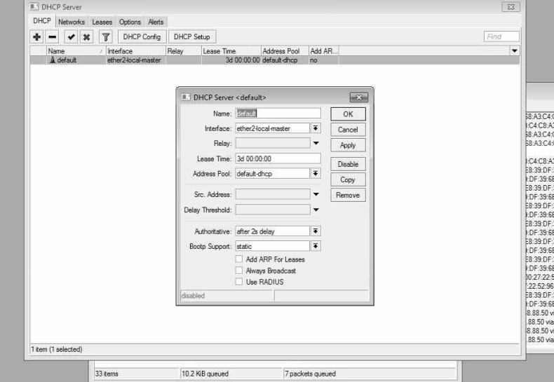

I’ll have to try that when I can. but lease time is definitely supposed to be default at 3 days
I know what the default is. I also know the default name for that dhcp server is dhcp1, not default, like your pic shows. Check to insure it is 3 days. I had mine set initially to 1 hour when I was testing this, and now I’m using 10 minutes to speed up the testing.
I just started the test again. Give me an hour or so to get a new log from my test and I’ll post it here. It looks just like yours, but only 10 minutes between deassigned/assigned message sets.
edit: Here it is. Look familiar?
[admin@test] /log> print follow where topics~“dhcp,info”
07:40:33 dhcp,info dhcp3 assigned 192.168.2.238 to 00:AA:BB:CC:DE:02
07:50:33 dhcp,info dhcp3 deassigned 192.168.2.238 from 00:AA:BB:CC:DE:02
07:50:37 dhcp,info dhcp3 assigned 192.168.2.238 to 00:AA:BB:CC:DE:02
08:00:37 dhcp,info dhcp3 deassigned 192.168.2.238 from 00:AA:BB:CC:DE:02
08:00:38 dhcp,info dhcp3 assigned 192.168.2.238 to 00:AA:BB:CC:DE:02
08:10:38 dhcp,info dhcp3 deassigned 192.168.2.238 from 00:AA:BB:CC:DE:02
08:10:39 dhcp,info dhcp3 assigned 192.168.2.238 to 00:AA:BB:CC:DE:02
08:20:39 dhcp,info dhcp3 deassigned 192.168.2.238 from 00:AA:BB:CC:DE:02
08:20:39 dhcp,info dhcp3 assigned 192.168.2.238 to 00:AA:BB:CC:DE:02
08:30:39 dhcp,info dhcp3 deassigned 192.168.2.238 from 00:AA:BB:CC:DE:02
08:30:40 dhcp,info dhcp3 assigned 192.168.2.238 to 00:AA:BB:CC:DE:02
– Ctrl-C to quit. Space prints separator. New entries will appear at bottom.
Add: I filed a bug report today with MikroTik. I’ll keep you posted.
two pics
Then your case is probably not related to mine. The frequency of my deassign/assign happens at exactly the lease time. If I change it to 1 hour, it happens at 1 hour, but only this client device. Other client devices on the same network do fine, and always do. This device fails the renew only at one half the lease time. Once the lease expires, it renews ok a few seconds later.
edit: I would still check “/ip dhcp-server lease” and see what is set in “last-seen” and “expires-after” for that lease.
