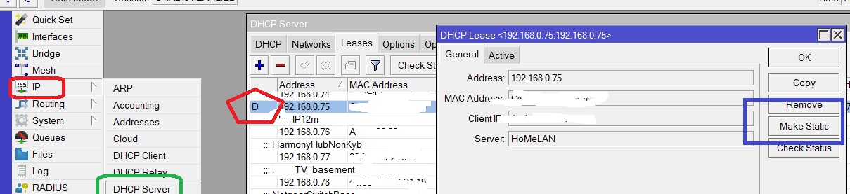

Have you seen this:
https://help.mikrotik.com/docs/display/ROS/DHCP
Upstairs, it is the binding MAC address. If the online notebook is often changed, the binding MAC must not work
Upstairs, fixed IP is assigned to the specified MAC address, not interfaces. For example, my router has 24 interfaces. I think the IP address assigned to the network cable of interface 10 is 192.168.1.10, and the IP address assigned to the network cable of interface 11 is 192.168.1.11, and so on. How to set this way, because the online client is a laptop, which is always changing, and there is no way to assign IP address according to Mac
