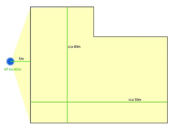

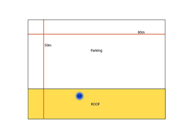

Locations that I need to cover look like this:
  • location 1: AP is located under the roof of the building, which is located 5m from the area I have to cover
  • location 2: AP is located under the roof, 4-5m above ground

You have added pictures meanwhile. Good. I would use sectors, especially due to low transmit power of clients. Maybe two sectors with different frequency per each place - depends on number of devices you would like to serve there…

Currently, we need to cover 3 areas like the one on the pictures above. So we have our main building where WAN link comes in, “high ground” building which will host Omnitik and to which all other locations will connect. It’s the only option to have a clear line of sight. Currently, I need to cover cca 180° radius from “high ground” building to see all clients. They also aren’t all in the same height. Main backbone link is in the same height, 500m away. Clients are 5-10m lower and 80-200m away.
