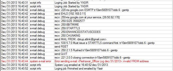

facing an issue in the script…!
my email smtp server settings is ok..mikrotik can send emails except mikrotik logs file it gives error “invalid FROM address”
while it can it can send other emails and delete the created log file from memory. please have a look in snapshot.
Try entering a from=“name” or email address when you send the message.
/tool e-mail send to=“xxxx@xxxx.com” from=“from@domain.com” subject=…
with tls=yes option including in the script it works…
cheers :slight_smile:
