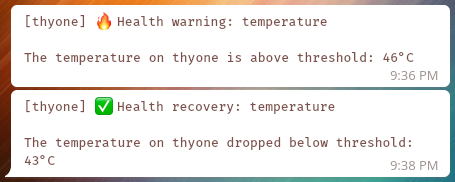

BTW, this also can send notification to via Telegram. I have messages about temperature alert and recovery in my history, looks like this:
