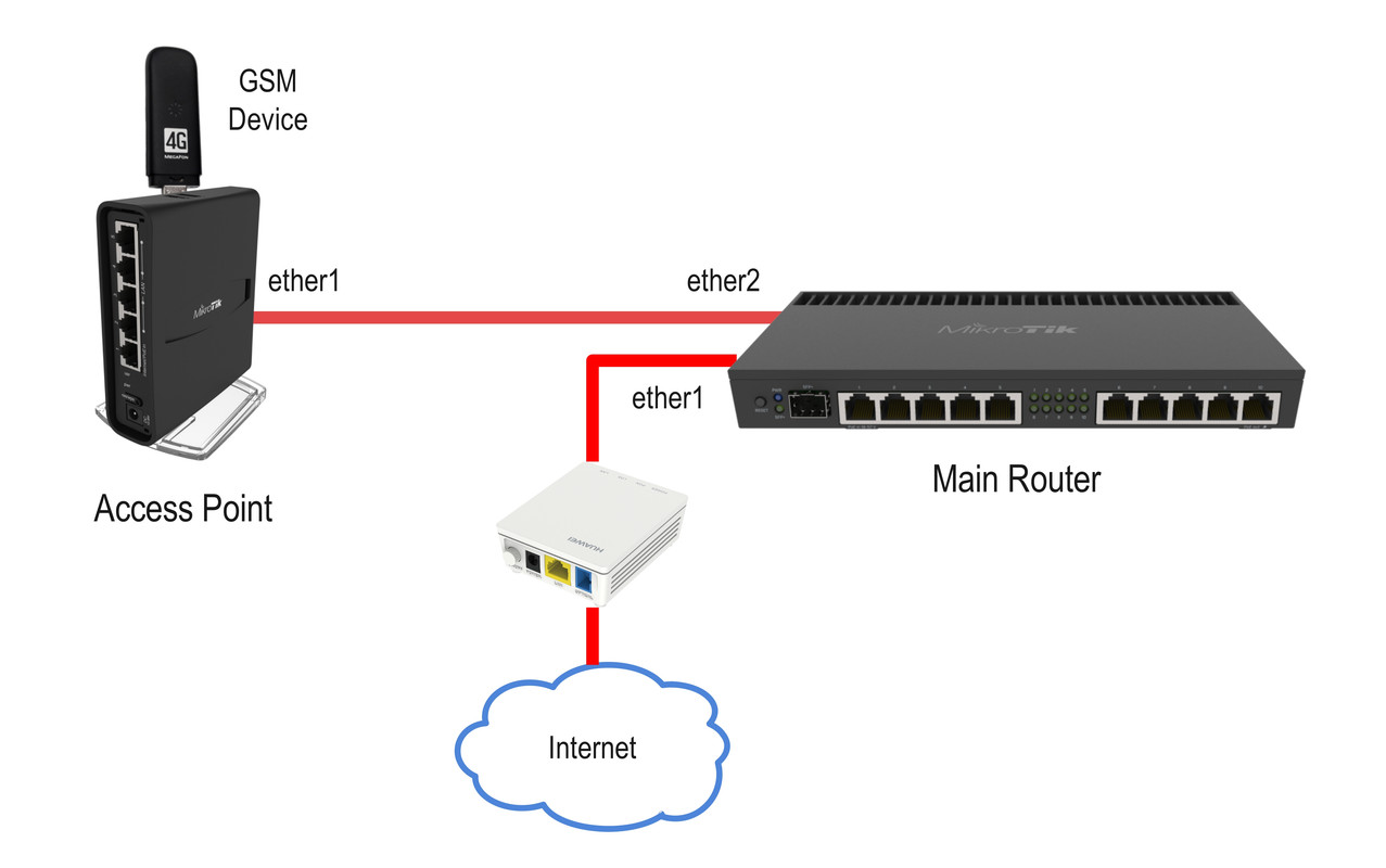

Hello, I am in the same situation.
I want to take advantage of the LTE device to be able to send SMS from other computers within my LAN.
In this case I want to send sms from the RB4011 using the “usb1” serial port that is on the AP.
Has anyone managed to do it?
How would it be?
By SSH or other means?
BR & tnx.
Well finally, I have done some research and the solution is offered by SSH.
