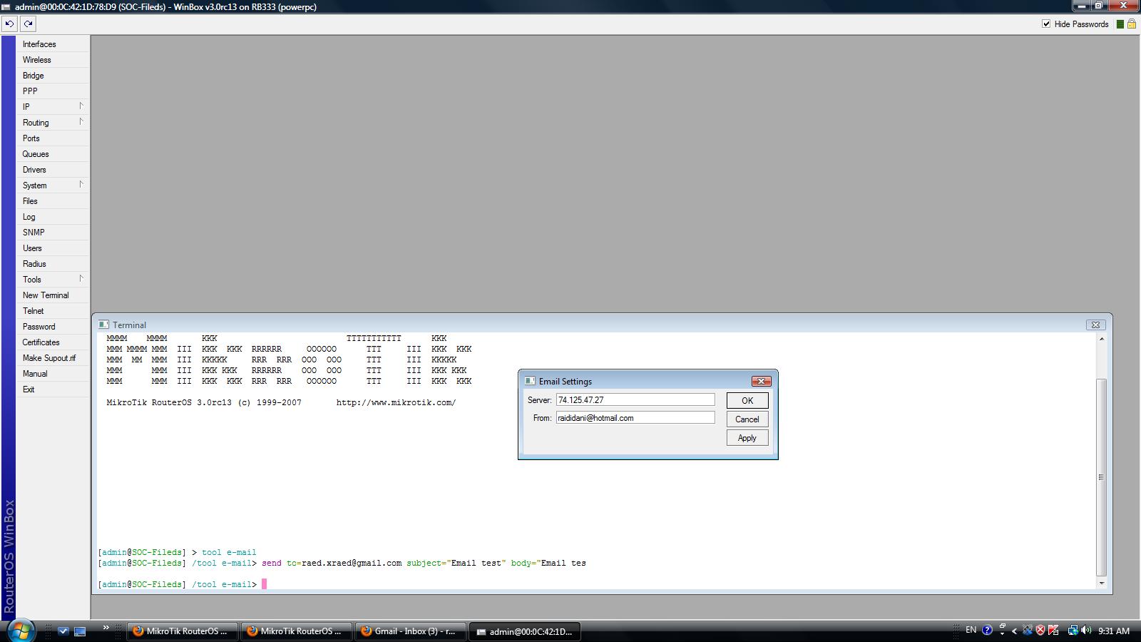

yes I did and got no error but never received any email even of hundreds of trials
pls find the attached picture
After you send a test email, are there any messages in the log?
What version RouterOS are you using? May I suggest upgrading to at least V3.30.
There is no log message and no error message after sending emai

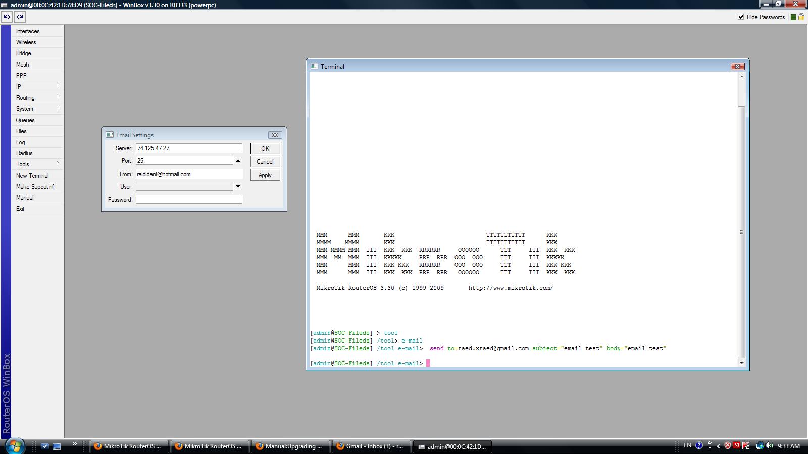

I upgraded to v3.3 BUT didn’t receive the email. pls see the attachment and could you please send me the command that you have used in sending email exactly?
as in attachment two text box appeared after upgrading ( user and password) I left them empty, is it ok or should be filled?

/tool e-mail
set server=74.125.47.27
set from=test@wififoryou.com
*leave user and password blank.
Then
send to=raed.xraed@gmail.com subject=“SurferTim email test” body=“Email test with RouterOS V3.30”
ADD: If you still have trouble, check the email server connection with telnet
telnet 74.125.47.27 25
You should get the name of the server and a 220 response. “quit” will terminate the connection.

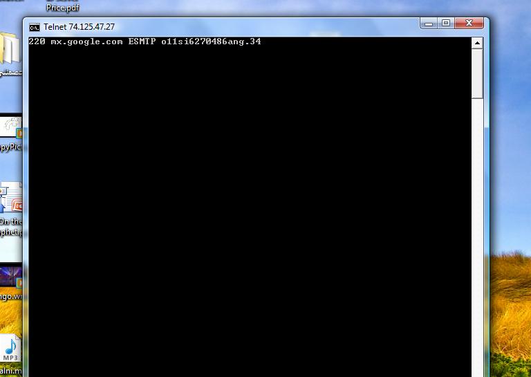

Did you try the telnet connection to the gmail server from a computer behind the router?
I got the attached rely from windows telnet
note this is the before the router
regards
