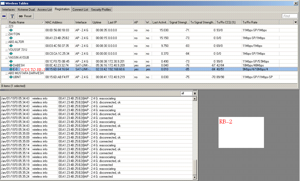

both links int he pictures gave terrible signal levels.
**we know that, but can that make a ) deauth (
and what the ) deauth ( mean ???**

you are receiving data from a device that’s not authenticated. could be an attacker, or a station gone mad. se the mentioned Debug Logs link, it explains all of your messages.
i didnt get your point, more details please.
I don’t think I can say it any different :slight_smile: These logs could be caused by a malfunctioning station, or somebody who is trying to attack your wireless network. These logs say “data received from somebody who is not connected”, ie. there was no authentication part, the station just began to send.
Dear normis
i wana know what exact ( sent deauth ) mean, and why we recive it from our custmers side ( some times ).
its mean, we recive it from WIFi interface, and its keep apper throw the links that are coneccted to that wifi.
ex. link1 >> link2 >> link3 >> wifi .
we have see the ( sent deauth ) not only in the wifi but in all links : 1-2-3.
I can’t explain it to you anymore. I already wrote everything :slight_smile:
1. the client has bad signal
2. it loses connection from the AP
3. the client apparently is dumb, and doesn’t notice it (bad software or driver)
4. client keeps sending data
5. AP says - what’s this? you didn’t make a connection? get lost!
