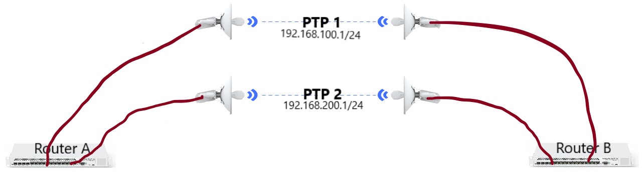

Sorry if wrong room, please help her friend all. from the image of the network topology that I include, whether it can request or tx from ROUTER A to ROUTER B through PTP line 1. and data received or rx through PTP path 2. its system is similar to nstream dualslave in mikrotik. so ptp 1 just passes the data tx from router a and ptp 2 just pass rx data. maybe this could be applied. sorry if my english is a mess. thanks
Yes, this can be done. You are effectively using 2 wireless links to make 1 full duplex wireless link.
I will do it via routing,
Create 2 routes on each side, then from left side, route via top link will have higher priority than route going via bottom link, and other side reverse this, I.e. Rout with bottom link gets higher priority that route with top link.
Then from left, you will send via top link and receive via bottom link, and vica versa for other side
thanks already answered my question. but here I can not find the priority column on the routes tab. where can I determine the priority of both routes I have made?
distance
