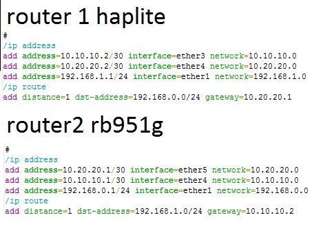

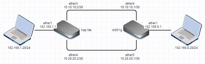

topology
config

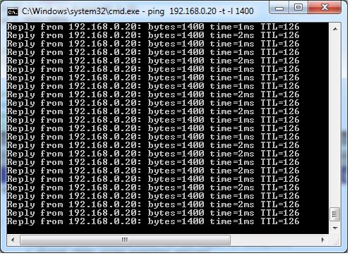

ping

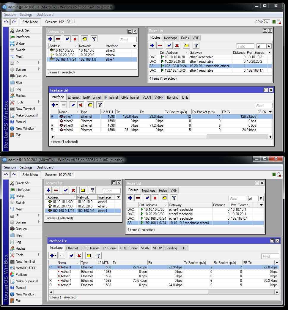

winbox with the traffic of ping from 192.168.1.20 to 192.168.0.20 and ping from 192.168.0.20 to 192.168.1.20
here we can see one way traffic going in one interface and another way traffic going for another, including winbox management traffic
That was not known before. If you have directly connected modems on both sides and routers behind them, use static routing as chechito wrote.
