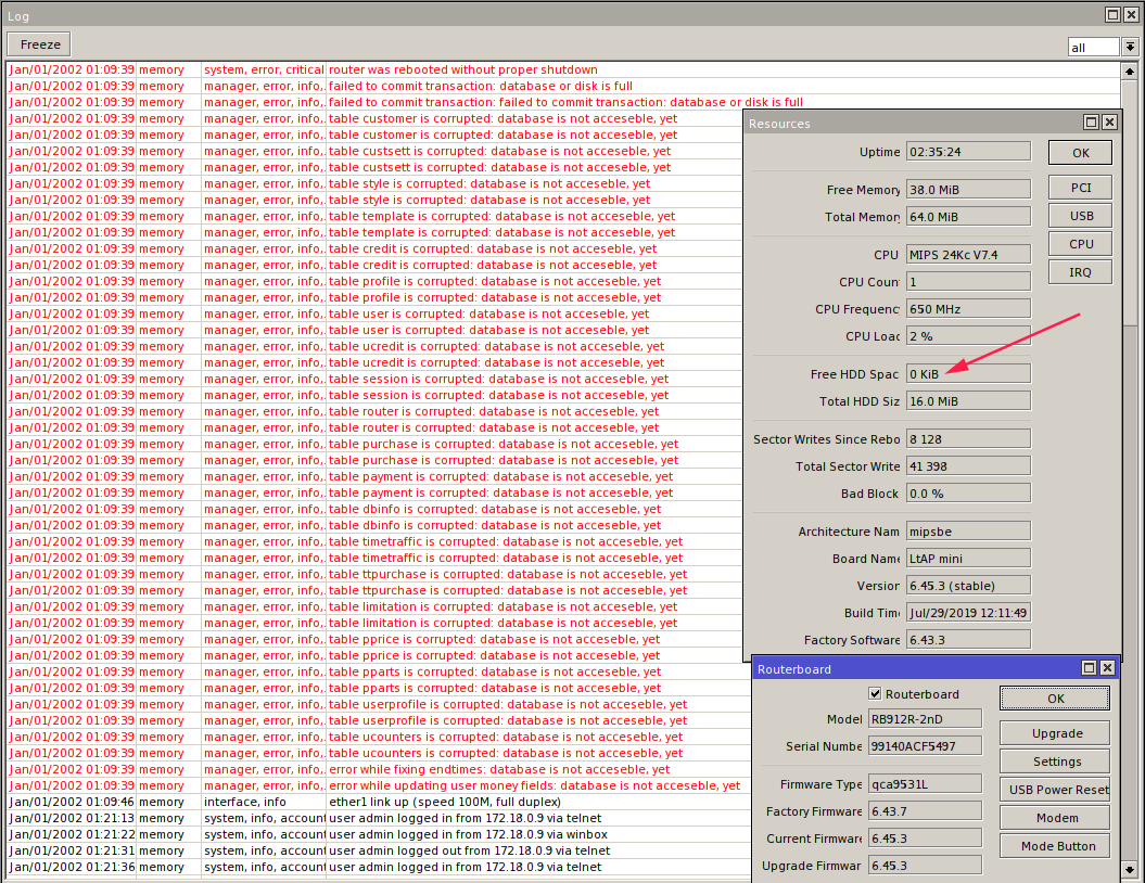

Serious problem: Free HDD Space 0 KiB, no space to save settings. RouterOS 6.45.3
I have two LtAP routers that are doing a VPN with each other. When I restart them the configuration is not saved due to lack of space in the HDD. Looking at the Log, these very worrying messages appear that refer to the corrupted database.
I checked for some script or something unusual but I can’t find anything.
Before configuring update to the latest stable version available (6.45.3)
In “File”, there is no file stored.
Anyone know how to solve this problem?
Log Information:
system,error,critical router was rebooted without proper shutdown
manager,error,info,debug failed to commit transaction: database or disk is full
manager,error,info,debug failed to commit transaction: failed to commit transaction: database or disk is full
manager,error,info,debug table customer is corrupted: database is not acceseble, yet
manager,error,info,debug table custsett is corrupted: database is not acceseble, yet
manager,error,info,debug table style is corrupted: database is not acceseble, yet
manager,error,info,debug table template is corrupted: database is not acceseble, yet
manager,error,info,debug table credit is corrupted: database is not acceseble, yet
manager,error,info,debug table profile is corrupted: database is not acceseble, yet
manager,error,info,debug table user is corrupted: database is not acceseble, yet
manager,error,info,debug table ucredit is corrupted: database is not acceseble, yet
manager,error,info,debug table session is corrupted: database is not acceseble, yet
manager,error,info,debug table router is corrupted: database is not acceseble, yet
manager,error,info,debug table purchase is corrupted: database is not acceseble, yet
manager,error,info,debug table payment is corrupted: database is not acceseble, yet
manager,error,info,debug table dbinfo is corrupted: database is not acceseble, yet
manager,error,info,debug table timetraffic is corrupted: database is not acceseble, yet
manager,error,info,debug table ttpurchase is corrupted: database is not acceseble, yet
manager,error,info,debug table limitation is corrupted: database is not acceseble, yet
manager,error,info,debug table pprice is corrupted: database is not acceseble, yet
manager,error,info,debug table pparts is corrupted: database is not acceseble, yet
manager,error,info,debug table userprofile is corrupted: database is not acceseble, yet
manager,error,info,debug table ucounters is corrupted: database is not acceseble, yet
manager,error,info,debug error while fixing endtimes: database is not acceseble, yet
manager,error,info,debug error while updating user money fields: database is not acceseble, yet

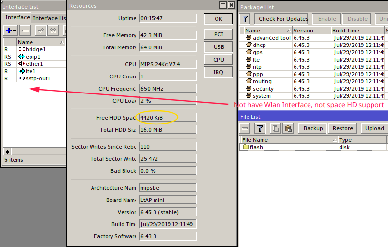

To get them to operate, I had to uninstall certain packages and stay alone with the basics, that way I achieved a space of 4 MB approx. Now if you save the settings and they remain after the restart.
However, there is still not enough space to add the wireless package, I can’t count on the Wlan interface.
I hope to correct it through a complete installation with NetInstall.
I think it should be considered, the manufacture of equipment with a capacity of 32 MB as a minimum storage space. Considering that the update package is 12 MB, how is it supposed to be updated with a storage space of only 16 MB?
You forgot to add Wireless package, that's why you lost wlan1 interface.
Yes, I added the wireless package I get a message that there is no space available !!! Do not install it, I have tried several times.
That was the reason to remove it and I am working without a wireless interface now.
Before netinstall, you could try with this https://www.mikrotik.com/download/share/fix_space.npk
It helped me with a misbehaving hAP once.
Also, you might not need routing, ntp, and gps packages

No, it’s the same as applying any other optional package: Drop it in root directory in files and reboot.
After it comes up correctly, the file is gone and you either got some more space or you didn’t.
I obviously can’t be talking about @comredperu 's LtAP mini with any authority, but it might just be in fine shape, only with too small a disk to fit every package available.
Over the last 6 months we’ve gone from 6.43. to 6.45. and the updates have gotten significantly fatter (system and wireless combined grew about 1MB, lte is additional package of nearly 2MB).
Yes, 16MB is too close for comfort, especially on lte enabled boards, but at this point we can only poke @normis about it and move on.
